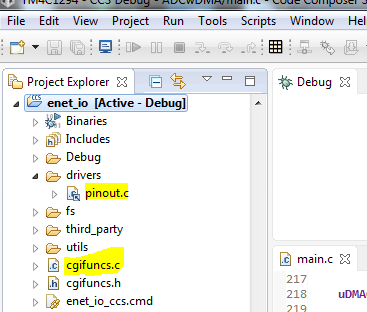

I made a new project by copying enet_io and renaming it.

When I open the pinout.c file in the original enot_io project my changes are in it too.
How was I to know this would happen?  What is this file behavior called and where should I read about it.

  • Hi Forrest,
    That is a good question. When that project was originally created, the file "pinout.c" was included as a link instead of being copied into the project directory. When you copied that project, it copied the link. There is a subtle indication when you view the file list in "Project Explorer". Notice in the snippet below that the icon for the file "pinout.c" has a small arrow in the lower right corner. That means this is a link. Compare that to the icon for the file cgifuncs.c. No small arrow means a copy of this file exists in the project.
  • You can right-click on the link and select properties. Here you can see that actual file location.
    You can delete the link and then paste a copy of the same file in your projects. Now edits will be to only the copy in your new project.

  • Hello Bob,
    Very nice explanation of the root cause of the problem I had. Once I knew what to call the problem, Linking instead of Copying, it was easy to learn more.
    I found a nice youtube at:  youtube.com/watch?v=ngp3b6ZhT8U
    Using your method to find the path to the file I copied it.  I then selected the project. Right clicked and selected too add a file.
    I got this dialog and selected to Copy file.
    Bingo the file is now in my project.
    Then I deleted the linked file.
    Got this warning
    Selected OK.
    I hammered the project (Build ...) and ran in Debug.
    It worked.
