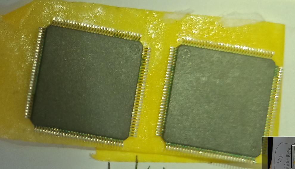

I find that the tm4c129encpdt on  the board which  the client sent back   became  green  as below。 can  somebody tell me  why?

    Copper is 'known' to 'turn green' due to simple oxidation. It is highly likely that (some) contaminate (possibly an 'imperfect' soldering or board-cleaning process) has produced this effect.    Staff's 'eagle eye' detects that this MCU appears to have been 'removed' from its assembled pcb - which 'removes' the ADDED CLUES - which such BOARD EXAMINATION (not just a single chip) would provide!   (i.e. how far did this contamination/oxidation physically 'spread' - what else & other areas - were impacted?
    No report of board/device performance arrived - nor of the 'operating environment'  (sub-surface, marine use - perhaps?)      That's of (some) consequence - is it not?
    Chip and/or Board Assembly ABUSE - or subject to severe moisture-laden environment (while improperly protected) (i.e. encapsulant-free) all may trump (other) explanations...

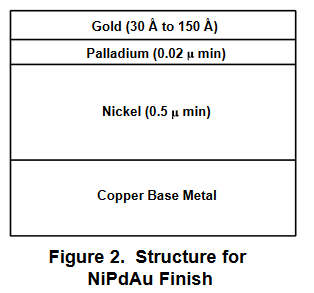

  • As listed in Appendix A of the datasheet, the leads are copper with Nickle, Paladium and  Gold layers on top (CU NIPDAU). As CB1 mentioned, copper will oxidize green. From the picture I cannot determine if the green color is oxidized copper or a containment left on the leads from solder flux or something else. As Danny F mentioned, knowing what happened to the parts might help, (storage, age, solder process, removal process). Why do yu ask? Was there a continuity problem before the devices were removed from the board? Here is the plating depth of different metals:

    Improper - possibly (even) acid-based solder flux - or board 'cleaner' - or some 'after assembly assault' - rapidly climbs - this 'green-tinged', Suspect List!
