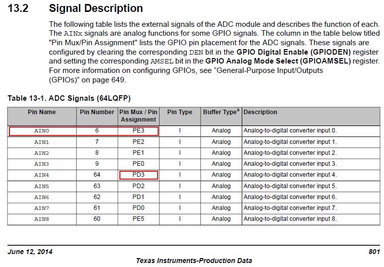

    How would I use ADC0 at PIN PD3 in the Launchpad?
    You would NOT!     Appears that you (still) are 'bit challenged' by the MCU's presentation of the ADC.
    Let's start w/the MCU Manual:
    You should note that AIN0 resides - NOT at  'PD3'  - but instead at 'PE3."     From where are you drawing such erroneous data?    (some other chip perhaps - it helps if  you explain...)
    My original post - in answer to your questions re: 'ADC4-ADC7' - was believed to provide you w/sufficient guidance - to enable you to configure your MCU to (any) of the ADC pins which your LPad exposes.   (i.e. brings out to the board's headers)
    You are silent as regards the, 'Proper Base Address' (0 or 1- never 4.)     The MCU's manual 'AIN0' nomenclature is properly noted as, 'ADC_CTL_CH0'.     (that should have been clear to you.)
