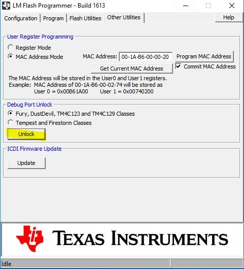

     If you are still unable to connect then please perform an unlock sequence using the LM Flash Programmer. See below. Bear in mind that if connection problem is due to your code re-purpose the JTAG interface for GPIO then the connection problem will occur again if you flash the same code.

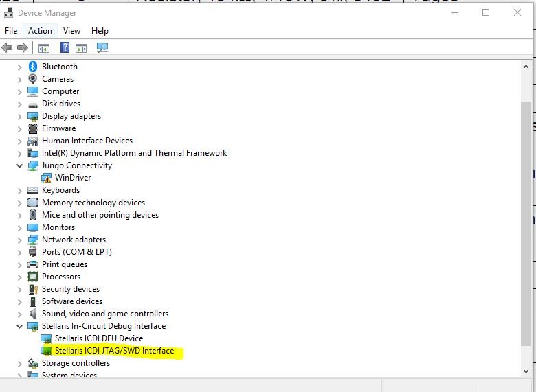

     1. Have you tried with another Windows PC and can you see in the device manager the Stellaris ICDI JTAG/SWD Interface?

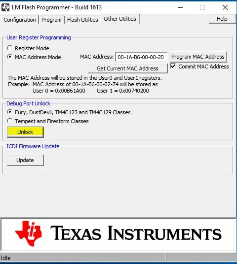

     2. You can restore the device to factory setting by using LM flash programmer.  In the Configuration tab first select the TM4C123 LaunchPad
     3. Go to the Other Utilities tab and click the Unlock button.

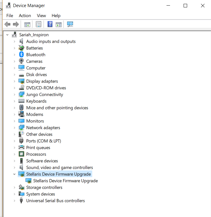

  • Hello Charles,
    when i connect the board via USB and open the device manager, then i have " Stellaris device firmware upgrade " instead of
    " Stellaris In-Circuit Debug Interface " which appeared when i connect another  tm4c123 board.
    should i still have to restore the device to factory setting ?
    Sarea
  • Which USB port did you plug into? There are two USB ports on the launchpad. You need to make sure you plug into the Device USB port, not the Device USB port. Please also make sure your power switch is selecting the power supply from the Debug USB and not the Device USB. Please try again and let me know the result.
  • I meant you need to connect to the Debug USB port, not the Device USB port.

  • Sarea,
    The reason I asked you to check is because that is only way I can reproduce the problem. If I connect to the device USB port then i will get exactly as what you had shown in the Device Manager. Since you said you connected to the debug port properly then we can rule out mis-connection to the Device USB port.
    The next thing is to do an ICDI firmware update. Go the LM Flash Program under the 'Other Utilities' tab you will find the Update button at the bottom to update the ICDI FW. Try to update it and see if it makes a difference.
  • Charles,
    I just update the FW as you purposed. the board has worked properly, i have tried to launch the debugger in CCS and blinking a led. its all okay.
