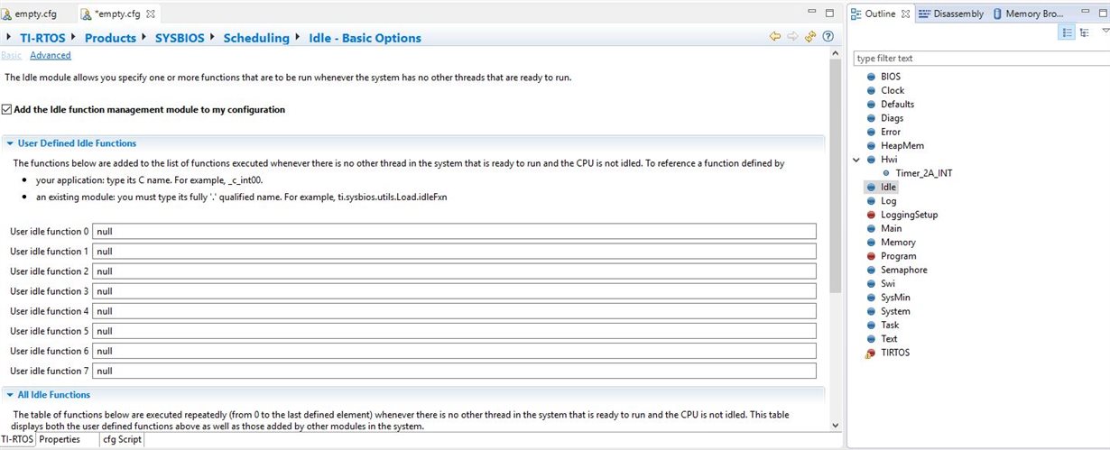

In the below code, The myIsr5(), myIsr6(), myIdleFunc() doesn't work..
I am able to set breakpoints on all of the above function but the program flow doesn't go into these function,
the messages inside those functions are not printed on the console window.

    After the System_printf() you need to add System_flush() in order to print to the console.
    You are calling Hwi_create(16...) and Hwi_create(18...) and these are corresponding to the GPIOA and GPIOC. Are you using these two GPIO modules to generate the interrupts?

          I started calling  Hwi_create(37) and Hwi_create(39) and these are Timer interrupts and I was not able to print the messages inside the myIsr5()and myIsr6() functions.
          I had also added System_flush(); command to the code.  Code looks like....
     I don't see in your code to configure the Timers. You only create the Hwi on vector 37 and 39. Even though these two vectors correspond to the Timer modules but they are not yet configured (i.e. setting up the period and enable the timeout interrupt and etc). Please take a look at the below example where Timer2 is used and the Hwi is created for vector number 39 which corresponds to the Timer2A.

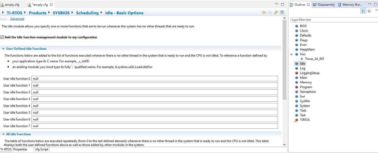

  • Hi Tsai,
              I have edited the code and the code is as follows. As of my understanding the code should operate the Hwi's and then the Idle function but the Idle function doesn't seem to be running. The code and the output of the code in console window can be as follows,

    1. Why Idle function is not running??
    2. TimerLoadSet(TIMER2_BASE, TIMER_A, ui32Period); From the above code I infer that the interrupt is occurring at every 500ms How to calculate the period for different millisecond value (like 1000ms,200ms, 50ms..) I can't understand the above API..
    3. ui32Period = (SysCtlClockGet() / 2);  I have set breakpoint in the above code that shows that the value of ui32Period is 512... What does it mean??? Is it certain register value... If so what is that name of that register??
    With regards,
    Naveen Kumar
  • Can you show your cfg file? Do you have the User defined Idle function? See below. Also place a breakpoint in  myIdleFunc() and check if the Hwi5 is true or false.
    The ui32Period comes from the line ui32Period = (SysCtlClockGet() / 2); However, the ui32Period is a API for TM4C123, not for TM4C129. I was showing you an example how to setup the Timer and didn't realize that you are using the TM4C129. You can replace the ui32Period with your desired timer period. For TM4C123 the SysCtlClockGet() returns the operating frequency in terms of number of CPU cycles in one seconds. With SysCtlClockGet() / 2 it is equal to number of cycles in 500ms. Anyway, you cannot use this API.
