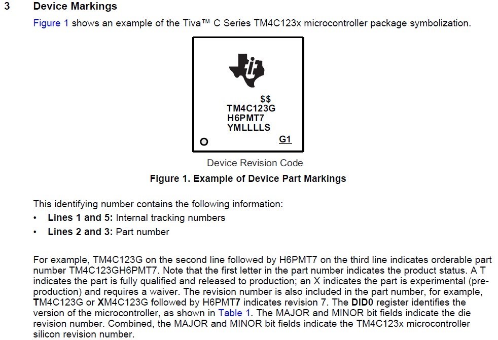

According with Tiva™ C Series TM4C123x Microcontrollers Silicon Revisions 6 and 7 Silicon Errata, it shows the following device marking:
So, the digit after the component part number should give me the silicon revision, but my device marking don't have this digit as show bellow:
Please help me to find the silicon revision to find out if this errata apllies to my device.
