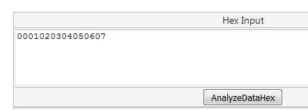

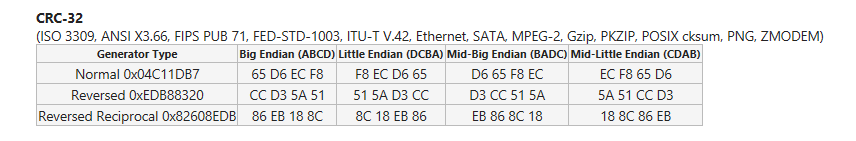

From an online CRC calculater I get these result when I input the same as in the example (0001020304).
we need this CRC check to cummunicate with a desktop application that we also develop.
In the desktop application we are able to get the CRC codes as shown in the table below. So what are we doing wrong in the TM4C1294?

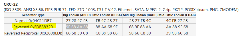

  • It appears to me that the algorithm for CRC-32 used on the website you cited uses a 32-bit implementation. The following code gives 0x9F68AA88 which matches the CRC-32 Reversed 0xEDB88320 pattern from the website:
