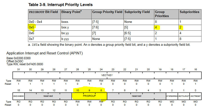

I need to set the sub-priority of HWIs of same priority group.
As per the datasheet of device, section 2.5.6 (page 120), it says that sub-priority of interrupts can be adjusted (if we reduce priority groups using APINT register).
How can we access and set this using XDC config tool of Hwi ?
I referred TI RTOS user guide and also SYS/BIOS Kernel user guide to find this, but in vain.
Pls help.
