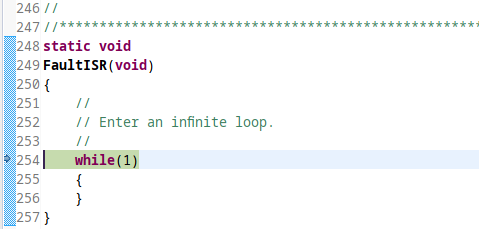

I used the debugger and I concluded that after every call
to a memory location defined by the preprocessor the program jumps to static void FaultISR(void).

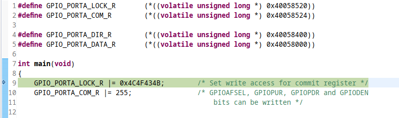

#define GPIO_PORTA_LOCK_R       (*((volatile unsigned long *) 0x40058520))
#define GPIO_PORTA_COM_R        (*((volatile unsigned long *) 0x40058524))
#define GPIO_PORTA_DIR_R        (*((volatile unsigned long *) 0x40058400))
#define GPIO_PORTA_DATA_R       (*((volatile unsigned long *) 0x40058000))
int main(void)
    GPIO_PORTA_LOCK_R |= 0x4C4F434B;        /* Set write access for commit register */
    GPIO_PORTA_COM_R |= 255;                /* GPIOAFSEL, GPIOPUR, GPIOPDR and GPIODEN
                                                bits can be written */
    while(1) {}
    return 0;
As seen in the above image, when running the debugger the first line that will be executed is line 9 in Code Composer Studio v8.
When I hit the Step Into (F5) button, the program jumps to the FaultISR as seen in the image under here.
I have my memory addresses from the datasheet so I asume they are correct.
Is there anything I am missing why I get the FaultISR if I write to a memory location that is in relationship to GPIO?

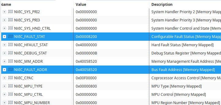

  • Dear TI community,
    I have read in this document that one should check the value of the NVIC_FAULT_STAT register.
    The image below shows the various NVIC_ registers with their values at the moment that we are in the FaultISR().
    The NVIC_FAULT_ADDR contains the address I just tried to write to. What would this mean and how can we solve this issue?

  • There appear '3 programming elements' which may explain:
    • You have NOT turned on the clock to Port_A
    • You have employed the cryptic, inefficient - and error-prone 'DRM' * style of programming.     (Vendor much prefers use of their, 'Long PROVEN/TESTED API.')   'DRM' is unproven - untested - predictably results in your 'Fault ISR' arrival
    • Port_A - to my best knowledge - has NO NEED for (any) Lock nor Unlock sequence.     (Only clearly defined pins - usually 'NMI' and 'JTAG' - require such 'unlocking.')
    Your search, find, and use of TivaWare - which contains the vendor's massive API (and many, many programming examples) is most 'Highly Recommended!'     Continuing 'DRM' usage ... Not so much.
