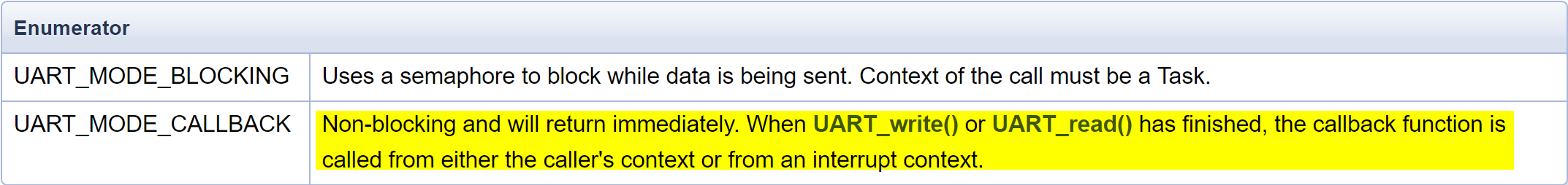

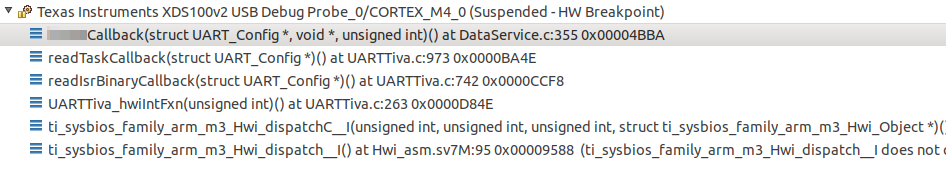

For the next step, I place a breakpoint at the beginning of my callback function. If I now stop through several breakpoint calls I can see the following: the callback function is either triggered by the HWI or a task (?):
What is the difference between the two calls? My question is pointing at this: within an HWI I cannot use or call any semaphore functionalities, whereas this is possible within a task context.
