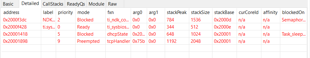

I am trying to write an MQTT publisher by adding the eclipse paho library to the one of the TcpEcho demos in the TI-RTOS library. The program sends 12 packets and then has the following error:
ti.sysbios.family.arm.m3.Hwi: line 1095: E_hardFault: FORCED
ti.sysbios.family.arm.m3.Hwi: line 1172: E_busFault: PRECISERR: Immediate Bus Fault, exact addr known, address: ffffffff
Exception occurred in background thread at PC = 0x0000de48.
Core 0: Exception occurred in ThreadType_Task.
Task name: {unknown-instance-name}, handle: 0x20001898.
Task stack base: 0x200018e8.
Task stack size: 0x800.
R0 = 0x200062fc R8 = 0xffffffff
R1 = 0x0000000d R9 = 0xffffffff
R2 = 0x00000001 R10 = 0xffffffff
R3 = 0x2000f53c R11 = 0xffffffff
R4 = 0xffffffff R12 = 0x00000001
R5 = 0x00000010 SP(R13) = 0x20001ef0
R6 = 0x0000000a LR(R14) = 0x00006e6b
R7 = 0xffffffff PC(R15) = 0x0000de48
PSR = 0x61000000
ICSR = 0x00423803
MMFSR = 0x00
BFSR = 0x82
UFSR = 0x0000
HFSR = 0x40000000
DFSR = 0x0000000b
MMAR = 0xffffffff
BFAR = 0xffffffff
AFSR = 0x00000000
Terminating execution...
I tried increasing the stack size in the .cfg but that didn't help
My task code is below:
