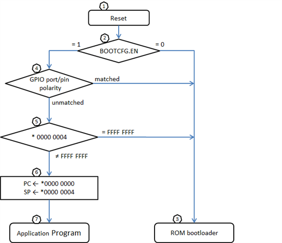

    I misunderstood the explanation of the EN bit.
    Is the position of ④(GPIO condition judgment) in the following flow correct, not on the EN = 1 side but on the EN = 0 side?
    Also, is the method of confirming that PB5 is HIGH with the reading of GPIODATA register (0x40059000) value of GPIOB ?
    Kyogo
  • Hello Kyogo,
    Your diagram is accurate, that follows with the flow from Page 672 of the device datasheet.

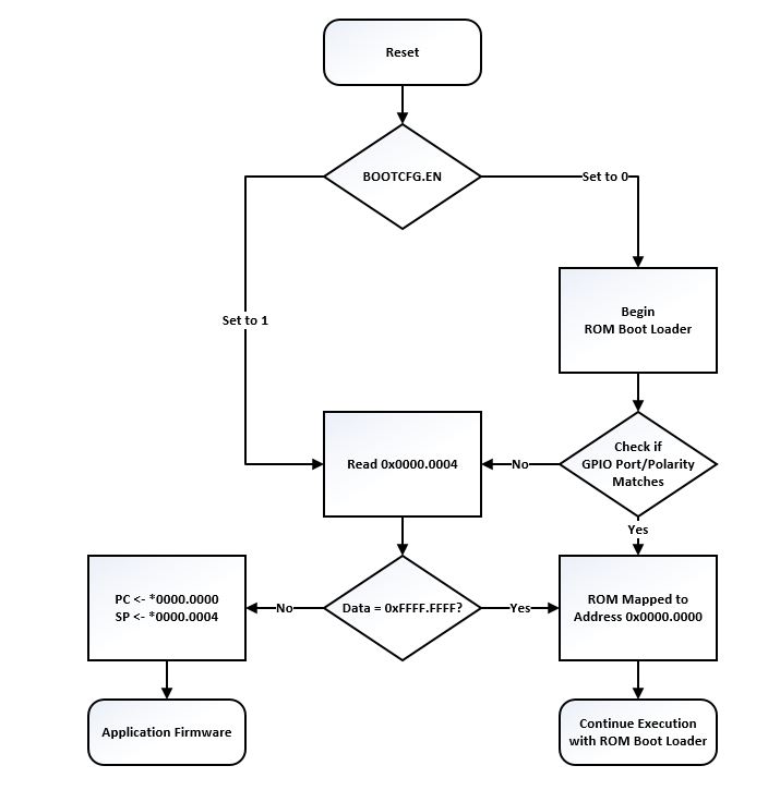

    I must apologize for my prior comment about the accuracy of the diagram. When I reviewed it, I thought it was accurate but I notice now two differences which need to be addressed. In order to best explain the process, I have put together a diagram myself which I hope will help show the process properly:
    Note that to get the GPIO polarity check to occur, EN has to equal 0, so you would want BOOTCFG to be 0xFFFF36FE.
    Please see if with that setting for BOOTCFG you get the desired behavior.
  • Hello Ralpf,
    In the data sheet, it was stated that Bootloader would not start unless the EN bit is 0, so I tried with EN bit = 0.
    We also confirmed that the value of BOOTCFG is 0xFFFF36FE.
    As a result, the situation did not change, the application started.
    Is not the branch of GPIO's polarity correctly done ?
    How can I check the polarity of the corresponding port / pin of the GPIO while the application is running ?
