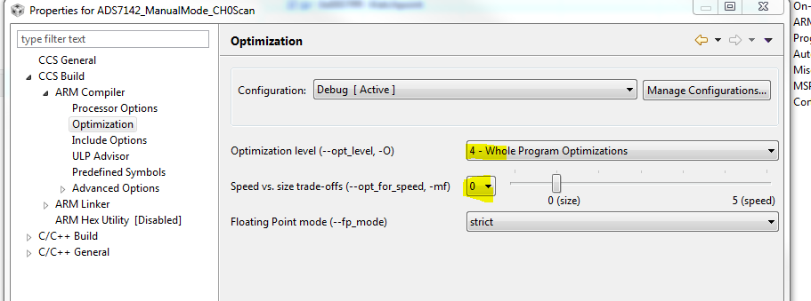

  • Yes, try setting your optimization level to 4 and the speed/size to 0 just to see if we can get your code to fit into 0x-0x3FFFF.

    I made the chnage you asked for. However, ( Opt 4 and speed 0 ) were giving me too many errors so I did ( Opt 2 speed 0 )which also decreased the size bellow 0x3FFFF. The current memory used is 0x0-0x2b938.  But still there's the issue with the timer. And I still don't understand why it doesn't happen on the first erase.
    I have attached the .map file for your verification.
