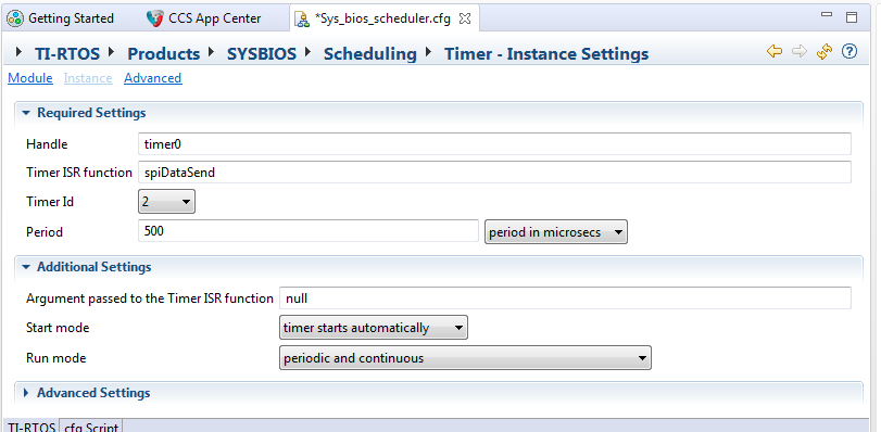

           I need to send data for every 0.5 ms through SPI protocol. I had configured timer stattically for 0.5 milliseconds and added the code for sending data via SPI, in ISR of the Timer configured, still it's not working. This is the code

#include <ti/sysbios/hal/Timer.h>

void spiDataSend()
    int l;
    for (l = 0; l < 8; l++)
     transmitBuffer[l] = array[l];
    int i;
    SPI_Handle spi;
    SPI_Params spiParams;
    SPI_Params_init(&spiParams);
    spiParams.dataSize = 8; /* dataSize can range from 4 to 8 bits */
    spiParams.transferMode = SPI_MODE_BLOCKING;
    spiParams.mode = SPI_MASTER;
    spiParams.transferCallbackFxn = NULL;
    spi = SPI_open(Board_SPI0, &spiParams);
    if (spi == NULL) {
    /* Error opening SPI */
    SPI_Transaction spiTransaction;
    Bool transferOK;
    spiTransaction.count = 8;
    spiTransaction.txBuf =  transmitBuffer;
    spiTransaction.rxBuf =  receiveBuffer;
    transferOK = SPI_transfer(spi, &spiTransaction);
    if (transferOK) {
    /* Error in SPI transfer or transfer is already in progress */
    System_printf("SPI Transfer is successful \n");
    System_flush();
    System_printf("transmitBuffer is : \n");
    System_flush();
    for (i = 0; i < 8; i++)
     System_printf(" %x ",transmitBuffer[i]);
    System_printf("\n");
    System_flush();
    SPI_close(spi);
void hw_init()
    Board_initGeneral();
    Board_initGPIO();
    Board_initSPI();
 *  ======== main ========
int main(void)
    hw_init();
   /* Start BIOS */
    BIOS_start();
    return (0);
