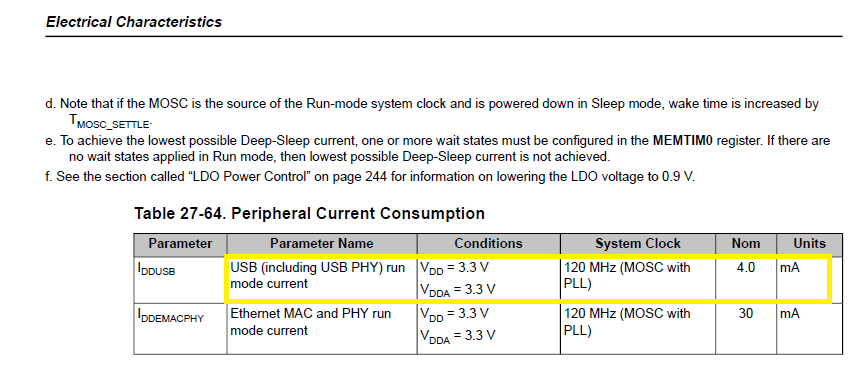

It would seem USB0 no matter what the PLL clock rate 30-60Mhz randomly disconnects USB0 bulk driver endpoint when ever PWM0 drives inverter at voltages above 24v. It would seem even 24vdc and PLLdiv=4 (60Mhz) USB clock is more stable than PLLdiv=8 (30Mhz). Yet quickly disconnects endpoint either way split potentials from linear supply bucks/+3v3 LDO to MCU and PWM inverter.
This seems more a HW issue of VDDC noise. The PCB traces VDDC pins are short, 3.3uf/100n caps placed next to pins per TM4C129x design rules, caps use digital ground trace not surrounding AGND.
Is the MCU internal +2v2 LDO the source for USB0 power ? is it possible choice 3.3uf being excessive should PWM0 produce transient upon VDDC? What are recommended VDDC cap values under typical MCU conditions PWM0 drives HV inverter? Would not that have been determined based on laboratory testing of VDDC with PWM0 actually driving a HV inverter? Such is questionable datasheet disclosure MIA or are we expecting far to much today?

  • We can unplug USB0 and re-establish endpoint connection after PWM0 is running and it may stay connected for a while then randomly or immediately disconnect.
    It would seem from that observation USB0 peripheral has DC noise specification, not listed in datasheet. Where USB0 peripheral sources DC is an important fact engineers need to know in order to make judgment for trouble shooting issue. To say no information on subject, an insane thought being TI logo is on the MCU.
    Note in this idea AINx Rs impedance reduces relative to larger value cap placed pin to ground. So 39n might set AC RMS impedance to 880 ohm, 1n cap 18k - 36k. TI Tina AC analysis confirms this finding the TM4C1294 datasheet seems to omit. Point is 39n adds serious roll off to the signal and produces longer hang time for transients to adversely inflict the MCU. So to say keep impedance low may be a double edge sword.
  • It would seem we are expecting far to much from the greatest silicon manufacture on earth to ask how USB0 gets it's juice to run. Perhaps its the ice cream man we need to ask such difficult questions and unlikely has the green popsicle of choice been given fair review in that cold ice box.
  • Buried deep in the bowls of datasheet lies clue we seek.  However adding TVS diode to VDD near USB0 side of MCU did not stop client disconnects.  Have to wonder if PCB frame ground to USB mini jack shield being separate AC bonded earth ground is causing analog interference. Letting PCB frame ground float made no difference to stop USB disconnect. Added 3v3 TVS diodes to all INA240 transient pulse spitting outputs, again made little to no difference in USB endpoint disconnects.
     But at least we know where USB0 gets juice from as the ice cream man gave us a green popsicle.
    The LDO Power Calibration registers, LDOSPCAL and LDODPCAL, provide suggested values for the LDO in the various modes. If software requests an LDO value that is too low or too high, the value is not accepted and an error is reported in the SDPMST register.
    Note: When using the USB, Ethernet, EPI, and QSSI interfaces, the LDO must be configured to 1.2 V.

    Hey your ok many thanks for the efforts here this thread and past sorry for strange humor. Not much in the design guide regarding USB layout which were not long ago considered this custom PCB design. It would seem USB0 relies on both VDD and LDO in some way or another but how much each one, the harder question.
    Again 1.2v LDO pin 118 has 3.3uf + 100n near VDC pins, nearing 4uf shown in electrical specifications. Adding 3v3 TVS diode top of 100n near VDD on USB side of MCU pins did not help much, maybe a little. Adding TVS on 1.2v LDO would not clamp transient until 3.6v, futile to even try. EK-XL VDDC has 2.2uf + 100ns near VDDC pins and was less prone to GTO port disconnects. It don't take much of a power inflection to bounce USB0 end point even after the largest infliction has passed it remains volatile.
    Oddly GTO USB0 (EK-TM4C1294XL) would randomly disconnect end point, powered via onboard 3v3 LDO. The problem being reported past this forum was always present. In hind sight mostly cured adding 32uf electrolytic +3v3 LDO on launch pad. Custom PCB has +3v3 (TPS73533 3.3uf ceramic) powered by +24VS bucked to +5v (22uf ceramic) via 1.5Mhz Rohm switcher. Hard to imagine the bucks or LDO but perhaps cap related in some way.
