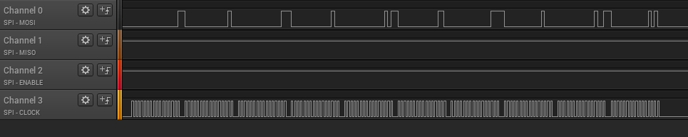

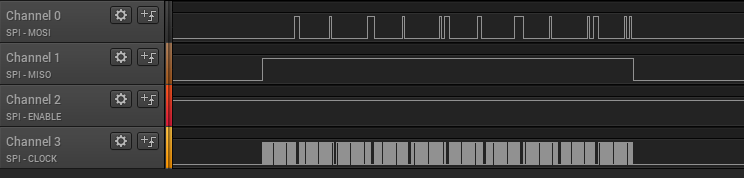

I am trying to set up a working example of SPI2 communication with hardware driven CS on the Launchpad TMS57004. I am using a logic analyzer to verify the output and the CLK and MOSI signals are working fine, the only problem is the CS0 signal. The signal stays high also during transfer when it should be low. However, if clear the CSDEF0 bit (actually invert the CS signal) in SPI2DEF register the CS starts working (of course in an inverted way). What have I done wrong?
Thanks for the help, Črt
CSDEF0 = 1, CS is not working (always high)
CSDEF0 = 0, CS is working inverted (as expected, bus useless for me)
