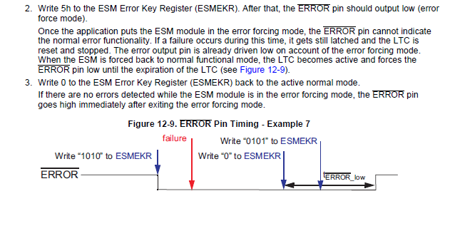

I am trying to implement error forcing on nerror pin as described in the TMS50LS1224 TRM (12.2.3 Forcing an Error Condition)
My concern is the point 2. contradicts to the figure 12-9.
As per the point 2. we need to write 5h to ESMEKR to force the nerror pin to low, whereas the figure 12-9 specifies write Ah to ESMEKR to force the nerror pin to low.
Is this is a documentation issue?? which one should i follow? or did i misunderstood ??
Please clarify on this issue.
Bharat
  • Hi Bharat,
    Thanks for catching this documentation error. The error forcing mode is activated by writing 0xA to the ESMEKR, as shown in the figure.
    I will file a documentation bug report, so that it is addressed in the next update.
    Sunil

  • Bharat,
    Writing 0x0 will immediately take the nERROR pin high if there is no real group2 or group3 errors while the ESM was in error forcing mode. In general, however, you need to write 0x5 to the key register to reset the nERROR pin. Then the pin will go high after the low-time-counter expires.
    Sunil

  • Hi Bharat,
    The nERROR signal goes High immediately after writing either 0x0 or 0x5 when the ESM is in an error-forcing mode. If there is a real ESM group2 or group3 error, then the nERROR signal will go high only by writing 0x5 to the key register. In this case the LTC defines how long the nERROR will stay low before the ESM switches back to the normal operating mode.
