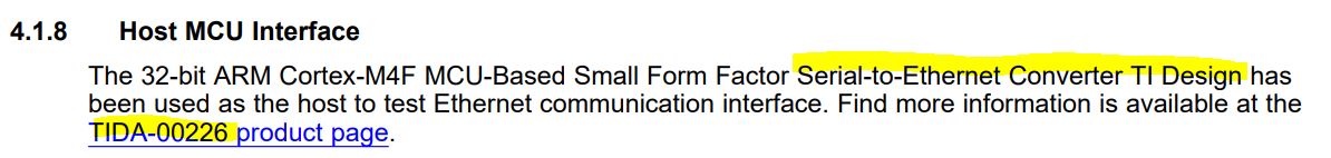

I am getting ready to use PTP in my existing projects using lwip stack. I couldn't find reference example from TI (there were a couple of posts on this forum without positive answer) . However, I came across the note TIDUAT6A which describes solution utilizing IEEE1588 and TIVA ARM MCU. On page 28 it is mentioned to substitute project specific source files in original TivaWare third_party directories. It suggests that some kind of code (merging lwip and ptp) should be available as example. Unfortunately, I cannot find the files for this project, design files, schematics etc. are available but I don't see C-project.

  • Hi Lukasz,
     I don't think the TIDA-00496 comes with the software by itself. If you read the page 28 again, it says for the host MCU interface  to refer to the Serial-to-Converter TI Design (the TIDA-00226) as a starting point and then make the necessary changes as described later in the document.
