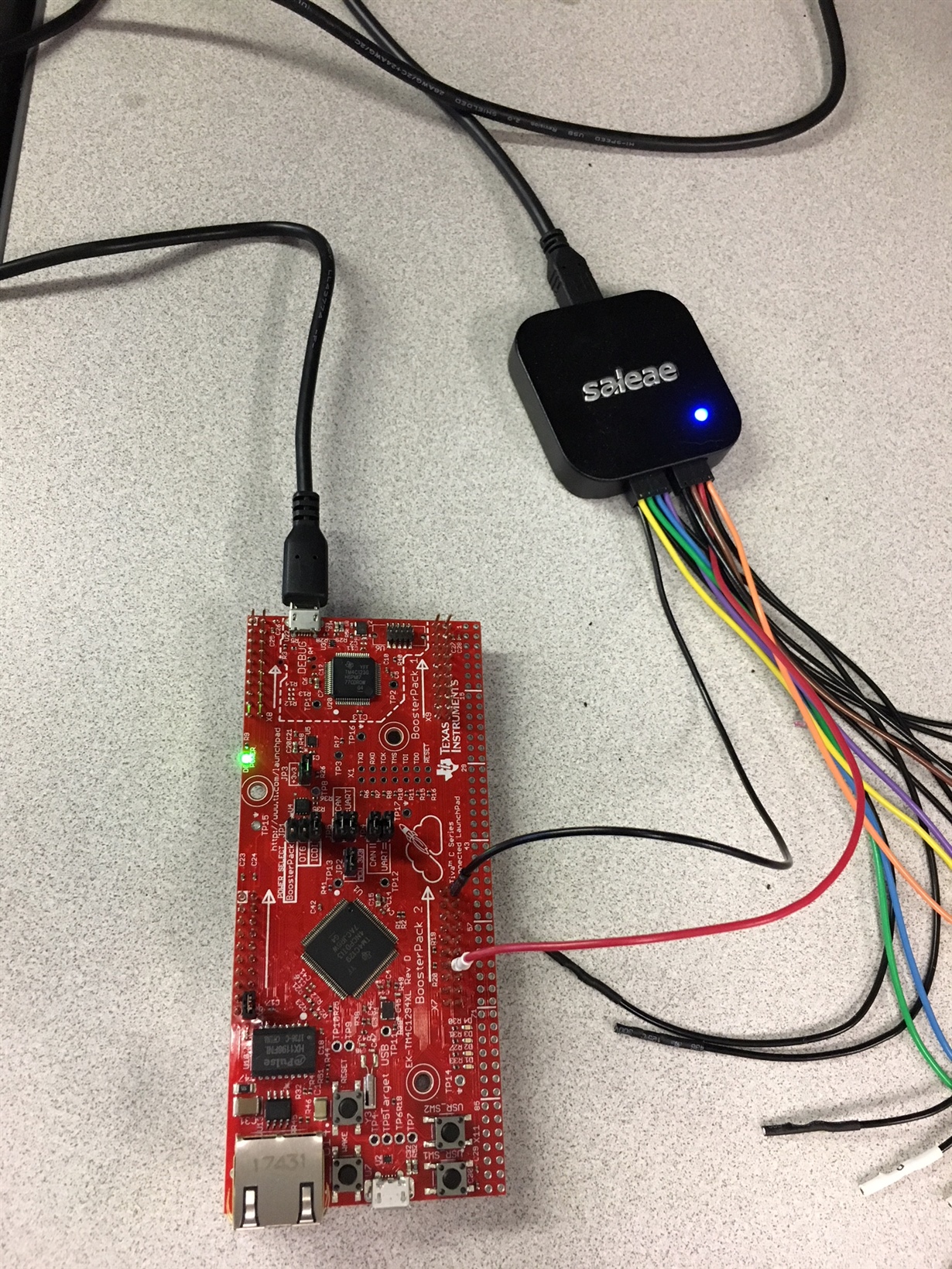

I have some problems on SSI of TM4C1294NCPDT on Tiva™ EK-TM4C1294XL Launchpad. The SSI is set as master, when transmitting data, the SSI do not work. The pin clock (PA2) do not change. I use the code provided by TI workshop as below. When running to the code 'SSIDataPut(SSI0_BASE, ui32Data)', all the SSI pins on chip do not change, and the register of SSIDR always stays zero. Could you please help me to figure out the problem. Thanks in advance...

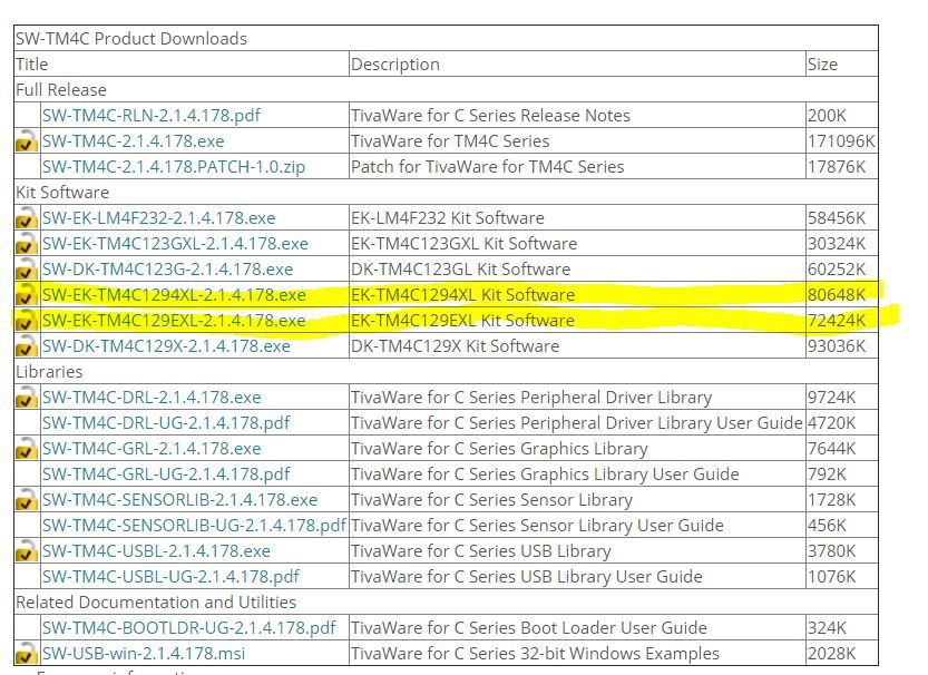

  • Hi Fatih,
     It seems to me that you did not have the correct TivaWare installed per your device. You will see <TivaWare_Installation>/examples/boards/ek-tm4c1294xl/hello if you install the TivaWare for TM4C129 properly.
     First go to and click on the 'Get Software'.
    Next click on either one of the highlighted in yellow.
    If you want to install the complete TivaWare which includes both the TM4C123 and TM4C129 and as well as all the libraries then you will click on the second one that says "SW-TM4C-2.1.4.178.exe"

    However, it did not still work I can see the clock signal at GPIO pin 2. SSI_DR is always zero.

    The PA5 was not connected actually but at least I was hoping to see clocking sequence from PA2 every time when SSIDataPut is executed.
    I shorted the PA4 and PA5 as you suggested but still I can not read any value in DR register.
    Another thing that I realized is that SSI_RIS becomes 0x00000048 at the first execution of SSIDataPut and then stays as it is.
    Earlier you were saying you were seeing the SPICLK on the PA2? Are you still seeing the clock? Why are you not connecting PA4 and PA5 to the logic analyzer? I also don't see you looping back PA4 to PA5 in your picture.
    Why don't you try writing a fixed value to the DR register. Do something like SSIDataPut(SSI0_BASE, 0x55);
    I was not seeing the clocking earlier too but I figured out why. I was connecting wrong wire from logic analyzer. I have never thought that could be the issue after observing that DR does not change at all.

  • I just run your code, not even touching a line and it works and I'm seeing both the SPICLK and SPITX on PA2 and PA4. Why don't you use a scope to capture the pins instead of logic analyzer. Sometimes, the LA is not fast enough to capture fast switching signals. You can also try to lower your SPICLK baudrate and see if your LA can capture them. In any case, I can see the SPICLK and SPITX on my bench running your exact program.
