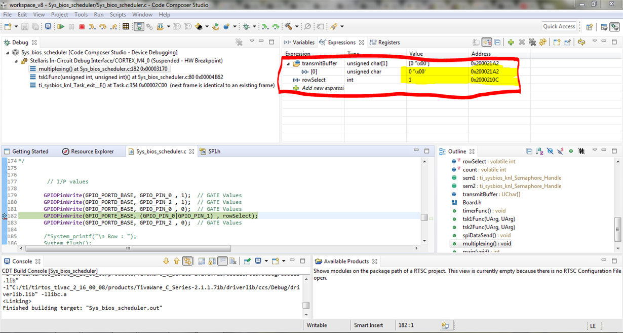

You can notice that the value in the tranmitbuffer is 0x00 Still the LED glows....
I am having certain doubts,
spi = SPI_open(Board_SPI0, &spiParams);
----> Do Board_SPI0 open the SPI on PORTD ???
 ----> In which register the value in the transmit buffer will be writeen ???
 ----> I can't able to see data value in SSI_DR_DATA - SSI Receive/Transmit Data

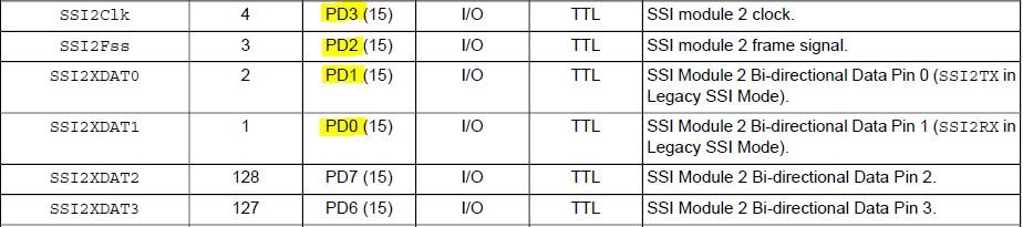

      If you look at the Board.h file the Board_SPI0 is mapped to the SPI2 of the TM4C129. In the datasheet, the SPI2 is mapped to PDx pins. This is your problem. You need to change the mapping to your desired SPI instance in the Board.h, EK_TM4c129EXL.c and EK_TM4C129EXL.h accordingly.

               After Charles said, I am writing 0x4 value to the pin 2 on the PORTD still the issue remains.   What I meant in my above post was "btw I had changed the value 1  to 0x4.. and thereby the code for Driver part works fine!!". When I tried set a breakpoint on "Spi_close(spi)", I can't able to get any values on the SSI_DR_DATA - SSI Receive/Transmit Data register. Also we don't have Scope facility in our workplace.

    In what register the value in the Transmit buffer will be written??? Do these  values will be transferred to SSI2XDAT0 (SSI2TX)pin???
    With regards,
    Naveen
  • When the SPI_transfer(spi, &spiTransaction) is executed will the SPI transfers begin. The spiTransaction.txBuf = transmitBuffer only assign the txBuf to point to the beginning of the transmitBuffer array.
    Once the SPI transfers start the data pointed to by spiTransaction.txBuf will be copied to the SPI module TX FIFO. The data in the FIFO will then be copied to shift register. This is when you will see the transmission on the SSI2TX or whatever SPI instance you are using.
