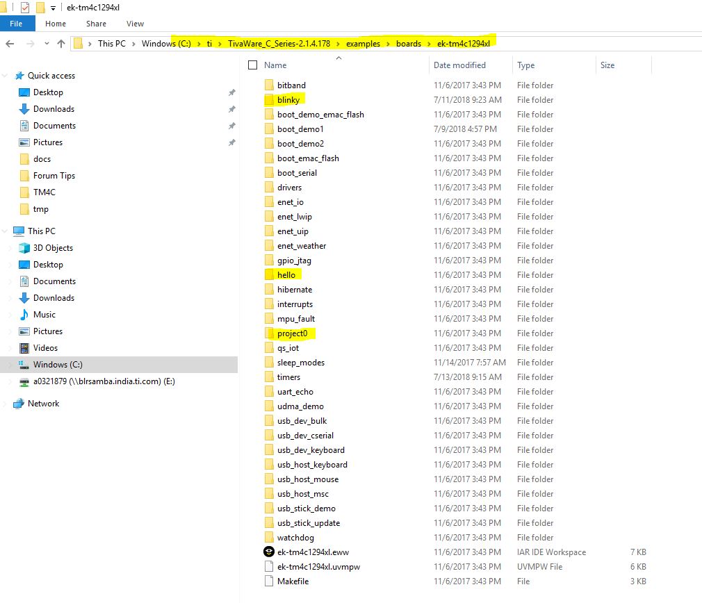

  • Hi Chris,
    There is a project0 example plus various TivaWare examples under <TivaWare_Installation>/examples/boards/ek-tm4c1294xl. Please import these projects into CCS to try them. You can start with the project0, hello, or blinky. These projects all have the device fully initialized.

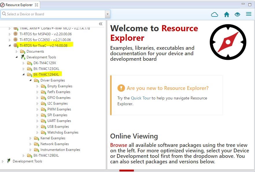

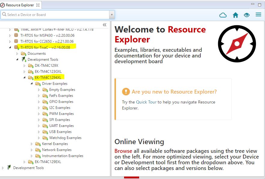

    Charles,
    Nope.

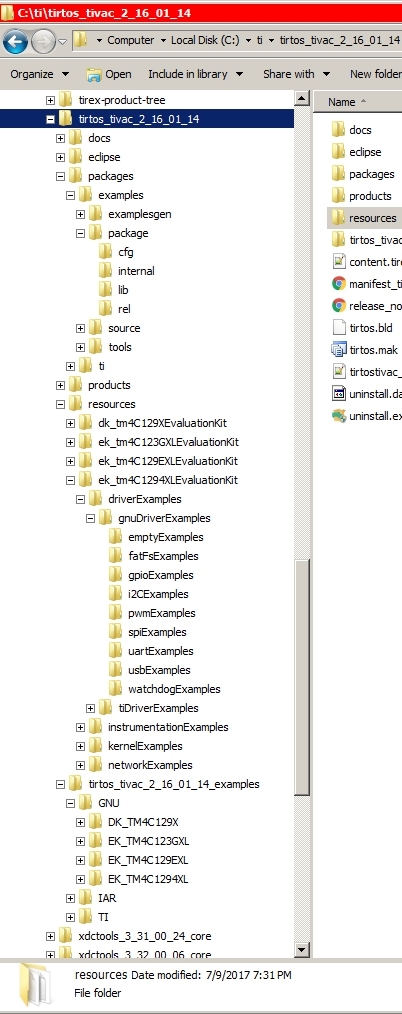

    The only "examples" folder I have is "tirtos_tivac_2_16_01_14_examples"  in "C:\ti\tirtos_tivac_2_16_01_14".  And CCS finds nothing in there to import.  See:
    I seached for any examples, and there is nothing that follows your "<TivaWare_Installation>/examples/boards/ek-tm4c1294xl."  folder tree.
    And I tried making CCS search from a root level, and got a massive list of things named "com_ti_rtsc_tirtos_example_xxx".  After digging through the list of over 300 of them, I selected example #141, and tried to import it (C:\ti\tirtos_tivac_2_16_01_14\resources\ek_tm4C1294XLEvaluationKit\driverExamples\tiDriverExamples\emptyExamples\com_ti_rtsc_tirtostivac_example_141.projectspec )

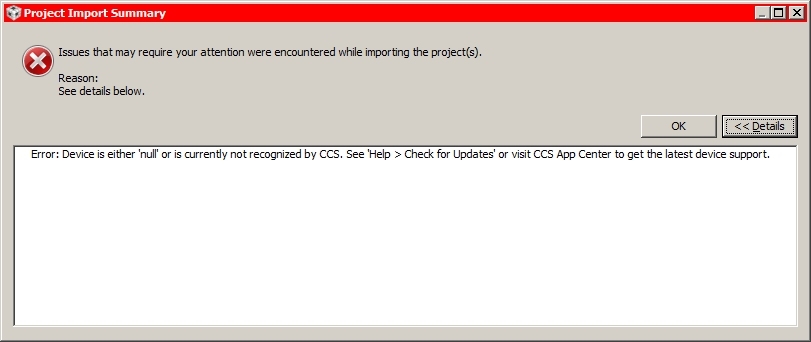

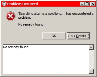

    It won't import, it gives me this error:
    Considering the TivaWare installation is older than CCS (I was using this almost 2 years ago with CCS 6.2, now I'm on 7.2 ) I don't see why updating is necessary...  and fails anyway.
    Cannot complete the install because one or more required items could not be found.
    Software being installed: CCS Flash Content 8.1.0.1297 (com.ti.dsflash.win32.feature.group 8.1.0.1297)
    Missing requirement: Debug Server - Win32 7.4.0.1313 (com.ti.ccstudio.debugserver.win32.feature.group 7.4.0.1313) requires 'com.ti.ccstudio.installer.win32.feature.group 7.4.0.00015' but it could not be found
    Cannot satisfy dependency:
    From: CCS Flash Content 8.1.0.1297 (com.ti.dsflash.win32.feature.group 8.1.0.1297)
    To: com.ti.ccstudio.debugserver.win32.feature.group 7.4.0.1313
    And this "super informative" message appears:
    All this, when all I want is a simple "empty example project with Main.c"...  which doesn't work with the GCC compiler...

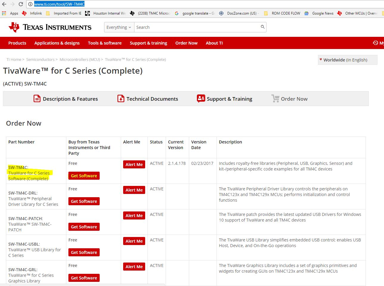

  • Hi Chris,
     Please download the TivaWare from this link which provides a suite  of software tools for the development of Tiva C Series-based MCU applications.
     Once you download them you will find many examples as shown below.
    The TivaWare examples are non TI-RTOS based. If you want to run some TI-RTOS examples, you will use CCS Resource Explorer to import these examples. I will suggest you start with the TivaWare examples first and once you are familiar with the device you can move on to play with the TI-RTOS examples.

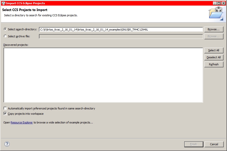

  • Charles,
    The example "project0" I pulled in with the resource explorer used the TI Compiler. It works.
    I also installed the package you referred to, however CCS did not prompt me with a "new package found"
    I was also able to get a "new Project" | "Empty Project" to run if it is set for the TI compiler, but not if it is set for the GNU compiler.

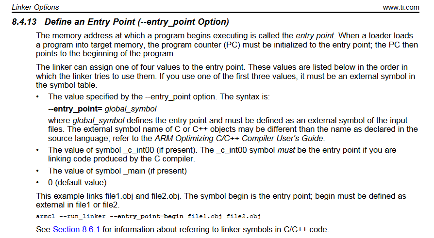

  • Christopher Weber said:
    However, my question remains about the TI. How did it set the entry point without the same "ENTRY(...)" that GNU needed?
    Sections 3.2 Entry Point and 3.3.1 _c_int00 of the TI ARM Assembly Language Tools User's Guide have some information on this. Basically, the TI linker appears to use a default name.
    If you look at the source code for the TI run time library, E.g. <ccs8_install_dir>ccsv8/tools/compiler/ti-cgt-arm_<compiler_version>/lib/src/boot_cortex_m.c the source code for the entry points can be seen. As of v18.1.3 there are four variants of the _c_int00 function, depending upon if arguments needs to be passed to main and/or C auto-variable initialisation is required. In the source code there are no attributes used to mark them as entry points; as suggested by the TI ARM Assembly Language Tools User's Guide the TI linker must have a built-in assumption of the default name of the entry point in the run time library.
  • Chester,
    Yes, you are correct and thank you for providing the answer. Here is how the linker does its determination:
