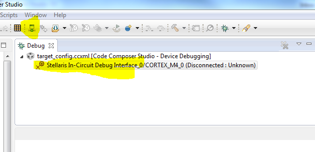

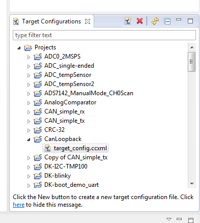

  • I start a debug session from the "CCS Edit" perspective by doing "View", "Target Configurations" if that window is not already visible. Then I select a target configuration, usually one associated with a project from an example I imported. Then I right click on the target configuration file and choose "Launch Selected Configuration".
    In the debug window I right click on the "Stellaris In-Cricuit Debug Inferface ..." and select "Connect Target", or click the connect icon.
    At this point, I can examine memory locations. If I want to program and execute, I select "Run" then "Load".
