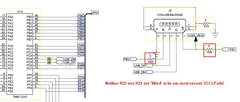

  • Greetings,
    Might the 'absence' of (both)  '0Ω resistors'  R25 & R29 account for poster's situation?      Several staff members recall both resistors - in the past - being present/accounted for!
    Neither firm nor I employ USB w/this board - yet this appears  a 'reasonable' explanation...     (one hopes)
    A 'quick/dirty' test  simply sees the placement of wire jumpers at screen locations R25 & R29.      (found just above the LPad's (aka lunch box's) J1/J3 header.)
    [edit]  Staff's (working) lunch-break uncovered:
    "OTG functionality can be enabled by populating R25 and R29 with 0-Ω resistors.    These resistors connect the USB ID and USB VBUS signals to PB0 and PB1."    Thus - resistor  'addition' - may NOT prove the cure!

  • OPss!! yes, you r right! R25,29 are not populated..I do not know could it be a reason, unfortunately, my soldering station was taken by my son and I will not have it before weekend.......... So, will install shorts soon and report back after. Thank you, Ralph, for the hint. Hope all will work, when my son return me my soldering station, do not want to switch to another kit, since only Ti kit allows simultaneous usage of UART and usb, device modes.BTW, any special reason, why it usefull to eliminate R25,29?
  • Hello Alexander,
    Those resistors, as cb1 edited in his post after realizing it, are only needed for USB OTG. They have nothing to do with solving your problem. As I said in my post, the usb_dev_bulk example will run fine without them.

  • Dear  RAlph, I populated the  R25,29, and as you told it did not helped. I can't make usb_dev_bulk from SW-TM4C-2.1.4.178/examples/boards/dk-tm4c123g   working. Could you please publish your working code tp let me try it? The  one that I downloaded from TI site a l-o-o-ong time ago refuse to enumerate and even isn't compatible with LED blink.

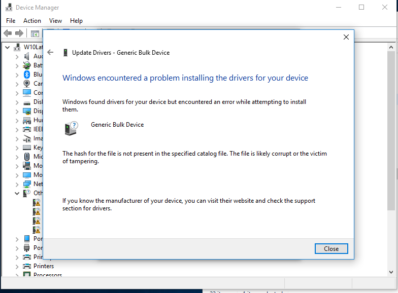

    4. An attempt to install win drivers from D:\SW-TM4C-2.1.4.178.PATCH-1.0(1)\windows_drivers cause error, see snapshot below
    5. Device manager see the board as ICDI- this is correct and  as a Generic bulk driver - correct, but OS failed to read device descriptor proper...
  • Hello Alexander,
    The hash file error occurred with a date mismatch with the device drivers a few releases ago. However, that is resolved in the latest drivers and I went back to confirm that is the case.
    Can you try uninstalling the current driver for the Bulk Device and then attempting to re-install with the Patch driver? That potentially could fix it.
    Maybe that will work, but my bigger concern would be that it may not uninstall the prior driver thoroughly enough to resolve the issue.
    Right now what probably is occurring is that there is another driver already installed using the same .inf name. We have seen that error with drivers that have been changed to include different devices, but the original was still installed by the same .inf name. The driver files are stored by the .inf file name, and having multiple but different drivers using the name confuses Windows. So if that original remains then Windows may continue to get it's wires crossed.

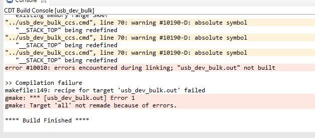

  • Ralph, following your instructions I copied original usb_dev_bulk project into Windows domain and opened it with ccs. However an attempt to build it printed out further errors:
    **** Build of configuration Debug for project usb_dev_bulk **** aaaany thoughts about it? Would you be so kind to publishyour working code? Is it anyhow different from officially released example?

  • Hello Alexander,
    I have made zero modifications from what is delivered with TivaWare.
    It looks on the surface like your project somehow has multiple .cmd files now.
    You mention 'copy' with regards to the CCS project, that makes me weary you didn't add it to CCS correctly.
    DId you use the Project -> Import CCS Project option? That is how you should add the project to CCS. By directing to the the folder C:\ti\TivaWare_C_Series-2.1.4.178\examples\boards\ek-tm4c123gxl\usb_dev_bulk it will pull the CCS project from TivaWare and link all dependencies correctly.
