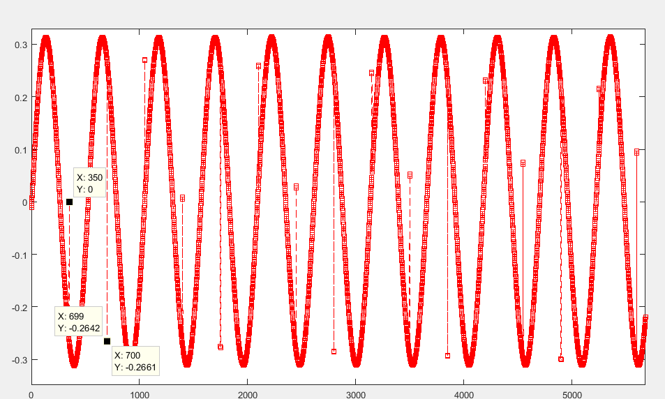

I am using TM4C1294NCPDT to receive the  measurements from ADS127L01 ADC. I am working recently on adding DMA functionality to my older projects. What my code does is it provides the SPI bus for communication with ADC, then data is send over tcp socket to the client device. Since, I need periodically to move data from fixed address to my ethernet buffer I decided to use DMA on RX FIFO with PING-PONG configuration. I did use it before in some other applications. The final result on the client side is almost the same as without the DMA functionality, the only difference is the last 2 samples of a buffer iare always corrupted.
I fill rdata2 buffer of size 700 (array of short type, 2 byte variable).  RX DMA on SPI peripherial gets triggered with 4 or more words in RX FIFO  and this is how I increment the pointer to rdata2 buffer. Code below presents the RX DMA interrupt, transfer variable is a size of a single DMA transfer and is set to 4, (condition on index size is based on 708 not 700 because there is some fixed starting frame (of size 8) in the ethernet packet) variable index is being reset to 8.
Basically, in this interrupt I keep track of the destination address, increment the Res_dest2 pointer (pointing to the rdata2 buffer) and reset it to &rdata2[8] once all if filled.

This data is received by the client and this is what gets on the output when reference sinusoidal signal is fed to ADC during test:
In zoom:
Since rdata2 contained raw measurements and actually 2 ADC frames represent one measurement index 349 and 350 correspond to last 4 values in the rdata2 array (rdata2[704]-[707]). As can be seen last 2 measurements are always corrupted but actually measurements with indices 1049, 1050 have correct values for indices 699 and 700. This is consistent through out hole measurement independent if it lasts 10 seconds or minute. It looks like the last DMA transmission for each frame is delayed and updates last 4 elements of rdata2 for the next frame.
After debugging I see that this is not a matter of ethernet communication or data conversion because inspection of rdata2 in MCU memory reveals that is happens at the MCU side. I have run out of ideas how this can happen. I did check indexing many times and didn't find any cause. Other thing is that other points are perfectly fine so there is something wrong with last DMA transfer (last DMA transfer of size 4 corresponds exactly to 2 measurements values).
The SPI clock is 15MHz with 16bit frame, SSI_FRF_MOTO_MODE_1 (required by slave ADC), working as master.
I will appreciate any ideas and comments.

  • Hi Ralph and cb1_mobile,
    Thank you for responses and help.
    As for Ralph suggestion I did the shift test and is as I have mentioned in the original question. Last DMA transfer (4 SPI frames) is shifted hole buffer apart. Red is the non-modified data, green are just the samples that were shifted (699 to 349, 750 to 350 etc...).Graphs below:
    Zoomed:
    I have made other experiment too. I count up to 704 instead of 708 in my buffer. It means that data [704-707] is going always to be zero. It truly is and the problem than shifts to samples [700-703]. This means that the problem always happens with last DMA transfer. I have tried inserting a slight delay between last DMA transfer and sending whole frame (rdata2), without any improvement (it is a kindof expected since DMA ISR is handled once DMA is done so delay shouldn't help).
    I have been working today on other approach with software DMA (SW configuration). I let the SSI RX FIFO interrupt notify me when 4 measurements are in the FIFO and then I trigger SW DMA. With this approach I get really good response:
    As cb1_mobile mentioned I theoretically can live with 2 samples being corrupted, especially that I can somehow now compensate for that. I just wanted to understand fully the problem, even for future reference.
    I can use SW DMA in my case, it is fine. However, theoretically ping-pong configuration is recommended for periodical stream from peripherial.
    If you have any thoughts I will discuss with pleasure,
