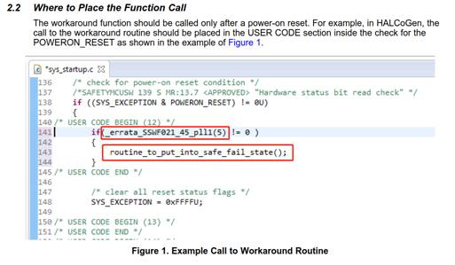

We are reading the application report of SSWF021#45 — PLL Fails to Start. workaround.
May i ask two questions:
1. what parameter should i input for the function call _errata_SSWF021_45_pll1() function ?
2. What should i do if the return of below function is not equal to 0 ?
