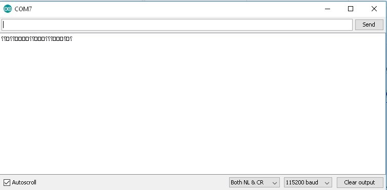

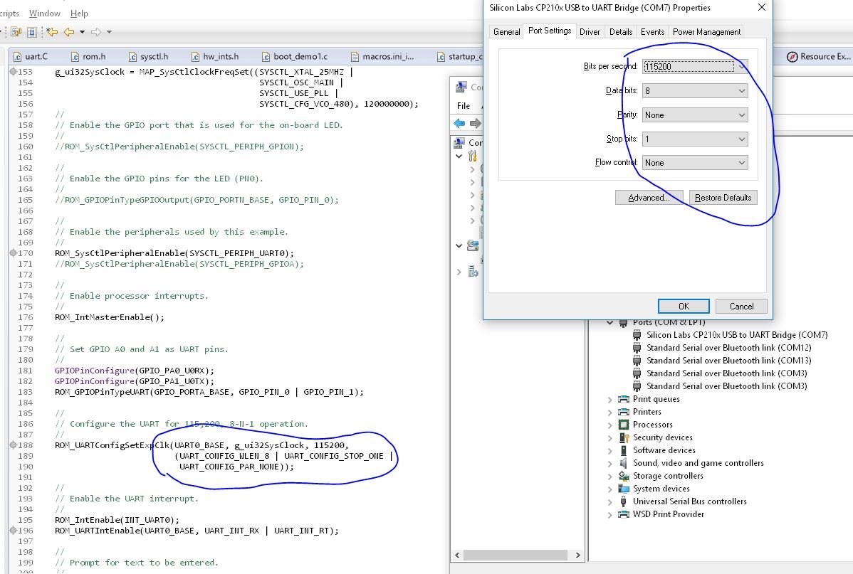

I rebuilt it, executed and put a breakpoint in the “UARTIntHandler” procedure to see that it stops when I send data through the serial monitor - which goes well, but the data being passed from the serial monitor and the chip seems corrupted - when the debugging starts, I should get the message: “Enter text:” but instead I get:
If I send any data, I don’tget it back – just corrupted chars as seen above.

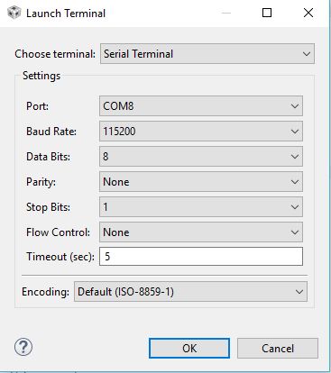

the communication in both ends is default and set to speed 115200.
Why is this not working?
