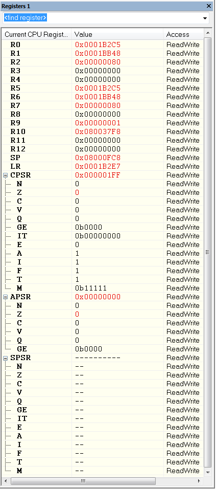

When I start from any other address like shown below, the RTOS stalls when it's creating the first task.
It stalls on the instruction "BaseType_t xRunningPrivileged = prvRaisePrivilege()" in xTaskCreate function below. My registers before and after are also shown below.
It vectors to address 0x8 (why isn't it vectoring to address 0x10108 if it's a real vPortSWI?). How should I define my linker cmd file and init vector table?

    The CPU has fixed addresses that it uses for exception vectors. These are all within the address 0x00000000 to 0x00000020, called VECTORS in your original linker command file. If you want your vectors to be starting at an offset of 0x10100, you would still need a "jump table" at the original exception vectors' location. So a reset would first jump to 0x0 and from there it would branch to 0x10100, and so on.
