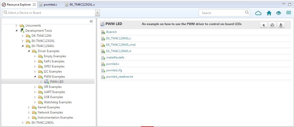

I am new to RTOS, I have been banging my head against the brick wall for a while trying to figure out what information it wants to configure the PWM's through RTOS. I can't find any examples/instruction on it. I need to use 6 PWM outputs BTW. I am just trying to configure one first, PWM_OUT_1 because I am leaving the LED flashing for now, and that uses the same as PWM_OUT_0.
I got the PWM_params down, that is in the example in the documentation. But I don't know how to configure the PWMTiva_HWAttrs and PWM_Config pointers. As in I don't know where to start.
I got a lot of good info from this thread but he is using MSP and all the MSP jargon makes it very hard to follow everything.

I think I finally got the hang of the PWMTiva_HWAttrs info from that post I mentioned. I just put it in my main.c file for now, does it have to be in a different file?
const PWMTiva_HWAttrs intensity_pwm_HW = {
    .baseAddr = PWM0_BASE,
    .pwmGenOpts = PWM_OUT_1,
    .pwmOutput = PWM_GEN_MODE_DOWN | PWM_GEN_MODE_DBG_RUN
const PWM_Config intensity_pwm_cfg =
 .fxnTablePtr = &intensity_pwm_fxnTable,
 .hwAttrs = &intensity_pwm_HW,
 .object = &intensity_pwmObjects
But I don't know what it is asking for and how to send it the parameters for the PWM_Config information. Is it something that is automatically generated or do I need to create the fxnTable, Objects, and does it point to the HWAttrs constant that I created before the PWM_Config?
