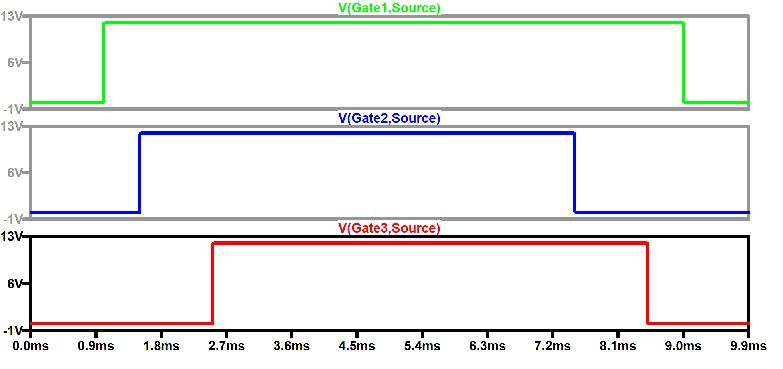

i want to create three single shots as a gate signal for three mosfets. the duty cycle is variable and can be changed with a touch display.
i configured three timer in single shot mode and tested it.
but the one shots comes one after another and not at the same time (similar to the picture)
is it even possible to do three one shots at the same time? What i am doing wrong?
thank you for your help.

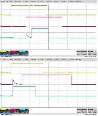

    • Instead - each Timer has '2' dedicated I/O pins - and when configured in One Shot Mode (Output)  - there is NO NEED for you to implement GPIO - nor GPIOPinWrite()!    Each Timer  Outputs (far more efficiently & automatically) FOR YOU!     (that same Timer pin switches to 'Input Mode' during Edge Count & Edge Time operation - and becomes 'output' during PWM and One-Shot!)
    • To generate all 3 such Timer Signals - in sync - I suspect depends upon:
    • the capability of the calling TWare function - to enable 'all 3 Timers' simultaneously - AND then each Timer's response proving equal
    • should NO TWare function exist to achieve such 'multiple, simultaneous Timer 'trigger function' - you may have to resort to 'DRM' coding
    • for 'DRM' or (even) 'ASM'  to succeed - it is required that the  'Capability to 'Synchronously' Enable Multiple Timers'  must (reside) w/in a  SINGLE Timer Register.   (which allows your simultaneous toggle of 'all 3' Timer 'Control/Enable bits' - via a  SINGLE Function Call!
    It must be noted that your 'bit large' timing diagram revealed the 'dependency' of each (following) Timer Output to 'Await the completion' of its predecessor - which (of course) was/is NOT your objective.
    The clues provided should best enable (your) resolution of this issue.    Again - the structure of the MCU's Timer Register (which may - or may not) provide for 'multiple, simultaneous Timer enabling' is (REALLY) the 'BIG DEAL' (actually the WHOLE DEAL) here!
    As a (far less effective) work-around (almost) - you CAN write to 3 GPIO w/a single function call - and all 3 will respond 'IN SYNC!'      Although then ' you' will (enjoy) the management of all timing - MANUALLY.    (Welcome to 1985 - and the Intel 8051 - and/or many derivatives...)

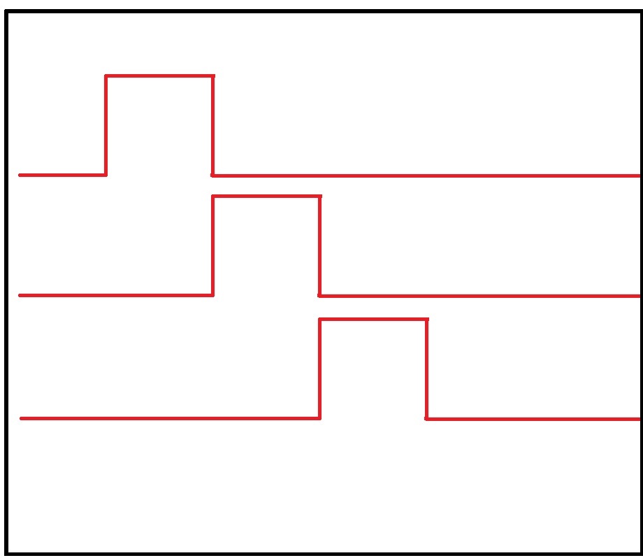

  • thank you for your answers.
    i am really sorry but i think i described what i need wrong.
    what i need is somthing like this:
    i want to start the pulse signals completely independent. i want to start the next one before the previous one stops. but now my next signal will not start until the previous one has ended.
    really sorry for my bad way of expression.

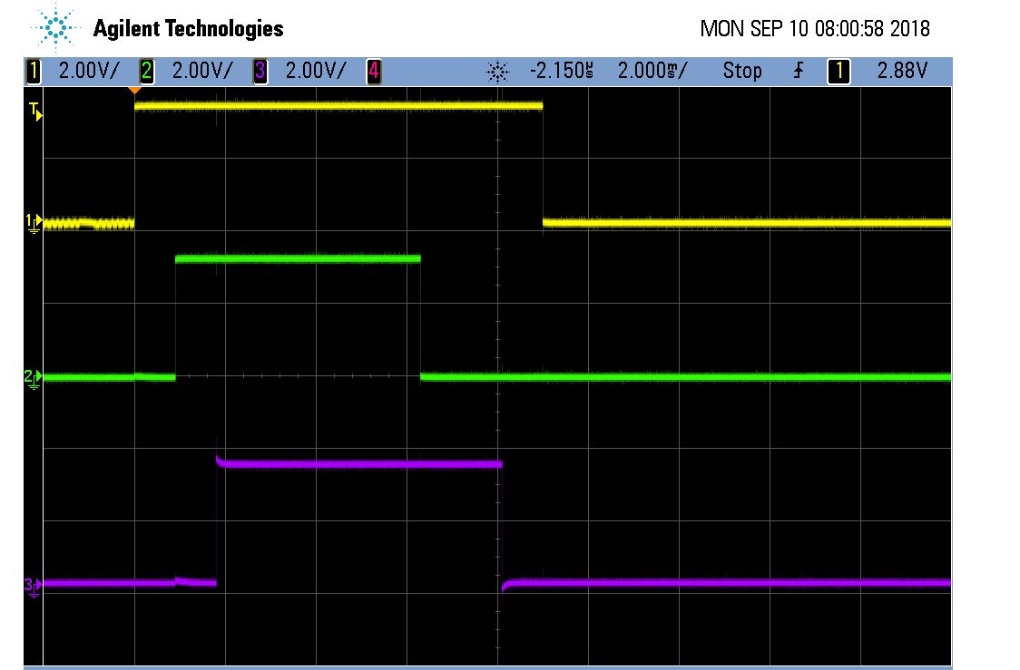

  • Ouch -  although technically - your NEW drawing DOES FIT - w/in your post's Subject Line!    (Shoot 3 single shots @ the same time - yes your drawing meets that description.)
    That said - as you 'rejected' your first drawing (the slightly LARGE one) - it seemed reasonable for your readers to believe that you (were) after Synchronization!   ('At the Same Time' (usually) suggests a Sync!)
    Let's look at your original post's wording:
    • "I want to create three single shots ... the duty cycle is variable."
    • "configured three timer in single shot mode."
    • "but the one shots comes one after another - and not at the same time."
    I believe that a 'better wording' would be, "One Shots are OVERLAPPING" rather than your Subject Line's "At the SAME TIME."    (that use of 'overlapping' escapes the suggestion of 'Sync'ed.')
    With this said - here's (what's believed to be) a 'reasonable' Method of Attack:
    First the Set-Up/Config. of  Three Timers ONLY!    (Note: Half-timers - if employed w/in the (same) Timer - will SYNC - thus violate your desire.)
    • Configure and 'make ready' three Timers - set to One-Shot Mode
    • As per my posting (above) - NO GPIO Outputs are required - each Timer provides its own Output
    • Note that 'One-Shot" Timer Mode provides 'NO/ZERO'  (direct control) of frequency or duty cycle!   Only that, 'Single Pulse's Duration' is controllable!   (you must control the frequency of 'Calls to Timer Enable' (for frequency control) and set the 'TimerLoadSet' parameter (for duty control).    NOT a particularly FUN Task!
    • Insure all three timers are presently Disabled (all timer outputs are OFF!)
    When that's complete - comes (now) the "Overlapping" Output:
    • Enable your first timer  (it will commence outputting immediately)
    • Either 'immediately' - or after some delay - Enable your 2nd timer  (it too will commence outputting immediately)
    • Repeat timer 3's Enabling - exactly as timer 2 - above
    Key Points - for your consideration:
    • Timers set to "one shot" will output immediately upon being enabled
    • Timer output will persist in accord w/the parameter w/in,  'TimerLoadSet()' - note that this is a, 'ONE and DONE' event.   (you must call timer enable again to output)
    • Successive 'Calls' to each, 'Timer Enable()'  - will (likely) launch the latest timer while the earlier timer(s) persist(s)
    It is expected that you STILL have the (incorrect) 'intermix' of GPIO WRITES and Timers.    As my 1st post detailed - the GPIO and the 'GPIO Writes' are NOT Required!    Each Timer has a dedicated pin for output and should NOT be set as a GPIO Output.   (as it clearly - no longer - is to perform as a GPIO)
    Do note - that 'You and you alone' have determined that, "One-Shot Timer Mode" proves best!    Due to the great demands of this method - especially if  these Timer signals are 'repetitive - or worse - periodic' - I'm fearful that  you've 'Chosen Incorrectly' - and that 'Periodic Timer Mode' operation (which automates frequency and duty cycle)   proves FAR superior.   Once again - posters provide 'INSUFFICIENT DATA'  (you are NOT alone) - and (hapless) helper crüe - may be made to (needliessly) suffer!
    I believe this is enough to, 'Get you Going.'    You WILL benefit from a SLOW (and repeat) Read of that 1st post - in which great detail was provided.    After that's agreed & understood - shift your attention to this posting - you should (then) be enabled to, 'Nicely approach your objective...'

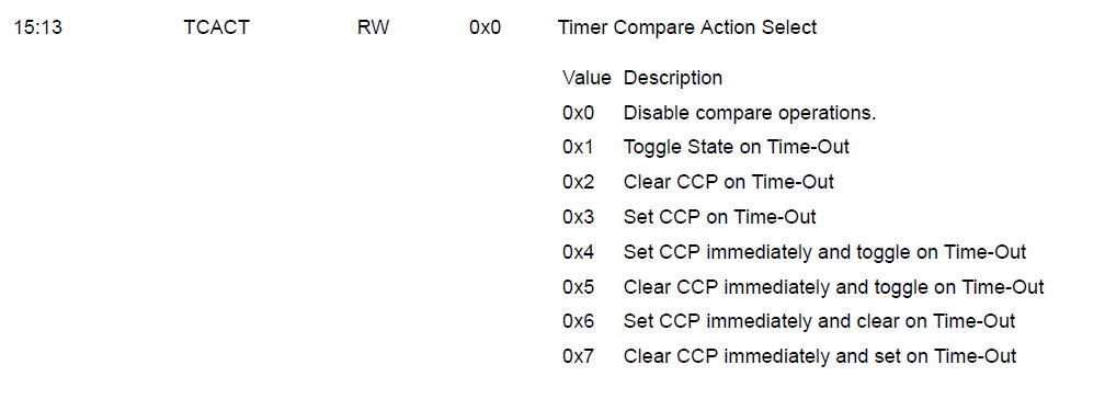

  • Hi cb1,
    You are correct that there is no need to configure or write any GPIO pins. His desired one-shot pulses can be met by changing the below three lines. The timer module has the built in capability to set the CCP pin immediately and upon timeout clears the pin.
    from:
    TimerConfigure(TIMER0_BASE, TIMER_CFG_A_ONE_SHOT);
    TimerConfigure(TIMER3_BASE, TIMER_CFG_A_ONE_SHOT);
    TimerConfigure(TIMER2_BASE, TIMER_CFG_A_ONE_SHOT);
    to:
    TimerConfigure(TIMER0_BASE, TIMER_CFG_A_ONE_SHOT | TIMER_CFG_A_ACT_SETCLRTO );
    TimerConfigure(TIMER3_BASE, TIMER_CFG_A_ONE_SHOT |TIMER_CFG_A_ACT_SETCLRTO );
    TimerConfigure(TIMER2_BASE, TIMER_CFG_A_ONE_SHOT | TIMER_CFG_A_ACT_SETCLRTO );
  • Hi Charles,
    That final parameter w/in 'TimerConfigure()'  (TIMER_CFG_A_ACT_SETCLRTO) was (outside) my expectations.
    May the following be noted:
    • it has long been staff's/my belief that the 'One-Shot' mode (itself) - causes the timer's output to (properly) extinguish!    (automatically - otherwise the name 'one-shot'  proves mis-leading!)
    • the example w/in the PDL User Guide - avoids the use of that 3rd (new) 'One-Shot Extinguishing' parameter!

     Here is description in the datasheet. First of all, the pin action can still be taken in 32-bit timer mode but restricted to even pins. The second paragraph describes a possible usage of the different pin actions. It is possible to generate periodic interrupt but restrict the pulse generation to the first interrupt. It is also possible to create variable duty cycle PWM by changing the the timeout period and the pin actions.
    Timer Compare Action Mode
    The timer compare mode is an extension to the GPTM's existing one-shot and periodic modes. This
    mode can be used when an application requires a pin change state at some time in the future,
    regardless of the processor state. The compare mode does not operate when the PWM mode is
    active and is mutually exclusive to the PWM mode. The compare mode is enabled when the TAMR
    field is set to 0x1 or 0x2 (one-shot or periodic), the TnAMS bit is 0 (capture or compare mode) and
    the TCACT field is nonzero in the GPTM Timer n Mode (GPTMTnMR) register. Depending on the
    TCACT encoding, the timer can perform a set, clear or toggle on the corresponding CCPn pin when
    a timer match occurs. In 16-bit mode, the corresponding CCP pin can have an action applied, but
    when operating in 32-bit mode, the action can only be applied to the even CCP pin.
    The TCACT field can be changed while the GPTM is enabled to generate different combinations of
    actions. For example, during a periodic event, encodings TCACT = 0x6 or 0x7 can be used to force
    the initial state of the CCPn pin before the first interrupt and following that, TCACT=0x2 and TCACT=0x3
    can be used (alternately) to change the sense of the pin for the subsequent toggle, while possible
    changing load value for the next period.

    from the beginning:
    i have three identical circuits which are cascaded. Each of them has a MOSFET. I want to generate three Pulse Signals for these MOSFETs with the TIVA C. The high level of the Signals and also the intervals/delays/spaces between the signals must be variable. It does not matter when the first signal starts but as soon as the first signal is started, the time sequence of the other two signals must be exact.
    With a touch display the settings will be configured. With the Sliders "Slider_E" the duration of the HIGH Levels will be choosed. With the Sliders "Slider_D" the delay between the Pulse Signals will be choosed.  With a start icon on the display the function "timer_start()" will be started and the pulse signals should be sent to the MOSFETs. After these one_shots the settings will be set again and send one_shots again.
    One of the possibilitys how these one_shots can be look like is:
    I hope I could bring a little more light into the matter.

    Your effort & care in producing this new (colored) drawing is memorialized & appreciated.    However,
    I don't know about friend Charles (he of the too early Sat. awakening) but your,  'Clause in highlight' - escapes my understanding!     (and then - even worse - 'exact' (always deadly) enters the picture!)
    You use the words, 'Time Sequence' - but don't (adequately) describe (or define ...or bound) what you mean by, 'Time Sequence.'     And again - you add 'exact' - which proves difficult - when NO SUCH EXACTNESS arrives - w/your (undescribed) 'Time Sequence!'
    By 'Time Sequence' did you mean:
    • the pulse width of each (there are 3) one-shot timer outputs
    • the 'timed spacing' between each timer's  'Rising-Edge'
    • the 'timed spacing' between each timer's  'Falling-Edge'
    • the 'Periodicity' of this '3 Channel sequence  (i.e. the 'timed spacing' between the 'first event' - of two (or more) such 'Timed Sequences.')
    • the new drawing shows Timer Outputs (2 & 3) as fully constrained (within) Timer 1's Output.    Is this - in fact - an ALWAYS requirement?     (the drawing cannot (properly) provide such detail!)
    • AND - is it true that the 'First Timer' will ALWAYS REMAIN First?    And Second Timer - Second?      That too - demands specification - does it not?
    What has been 'unknown' (and remains such) is how (or if) any one Timer's output is to 'impact or effect' (any) other Timer's output?     That's not been specified - has it?    That specification - and clarity - proves necessary - does it not?
    I provided a brief code block - in my last posting - yet received no (comment nor feedback!)      Yet - that code enabled, 'Precise Control' over:
    • each individual Timer's duration
    • the spacing between First Timer's (Rising) Output and Second Timer's (Rising) output
    • the spacing between Second Timer's (Rising) Output and Third Timer's (Rising) output
    • and the 'Delay' before that (entire) sequence repeats.    (Note that the sequence may continue 'Unchanged" or 'Selectively Changed' - my code accommodates either.    If there is 'frequent' sequence repetition - then a 'conditional statement' may 'speed & ease' - that code's 'Update Execution.'
    I hope that I've (better) illustrated what is 'normally required' - when specifying a, 'Time Sequence.'

    you can see the problem at the pictures here:
    either the signal two or three gets such a peak. the signal which receives the longer "delay" gets this "peak".
    in the upper picture the first "delay" was set to 8ms and the second "delay" to 11ms.
    in the lower picture the first "delay" was set to 6ms and the second "delay" to 1ms.
    i don't know where the peak comes from.

    So to explain what causes the peak is a bit difficult.
    I have three timers for the pulse signals right?
    First signal is on the pin PL4
    Second is on the pin PM0
    Third signal is on pin PM2
    These pins are my capturecomparepins.
    The peak shows only up on the pins with the same port.
    So when I switch from PM2 to PL5 then the peak appears between them.
    The problem is that the ccp pins are only available on the ports M and L.
    After a long look on the datasheet I found out that other pins can switch their standard function from for example I2C Pin to a CCP Pin. I must find out how I can switch from the standard function to the ccp function.
    Then it should be possible to solve this problem.
    I will keep you updated and I am open for advices.

        TimerConfigure(TIMER0_BASE, TIMER_CFG_A_ONE_SHOT | TIMER_CFG_A_ACT_SETCLRTO); //TIMER_CFG_A_PERIODIC  TIMER_CFG_A_ONE_SHOT

  • Hi Charles,
    thats awesome. Is this made with the code i uploaded?
    There ist nothing connected to the microcontroller except the touch display and the scope.
    I will try simple like you said. :(
  • I don't believe this. It is the oscilloscope!!!! I have now measured with an older oscilloscope and it works perfectly.
    i am freaking out!!! Tomorrow i will measure it with the scope where i work. If there is no problem then there is only one problem left ^^
    the problem i mentioned it before. After all settings are set and the "GO" icon is pressed, the signals will be shot.
    after that i habe to press the reset button on die µc to make another shot. otherwise it doesn't give any other output signals.
    I debugged that already step by step with breakpoints. According to the progress of the debugger, the new values ​​are taken over and passed to the timer but no signal comes out.
    is there anything like timer-reset or something like that?
