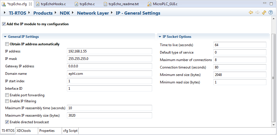

Respected sir,
            I am new to Networking and TCP\IP. I am trying to modify tcpEcho_EK_TM4C1294XL_TI_TivaTM4C1294NCPDT example. I want to send packets at 1 ms interval on static IP. I have done static ip settings as shown in attached image. But i am not able to communicate with my laptop and i am not able to PING also. So how to do static IP configuration so that i can ping with my laptop??

             i have managed to configure static IP. I can ping and transmit receive  packets.  Now  i am working on  recv()  and send()  functions.
    What have found is that i can use these function only inside tcpWorker() task . I tried to use it inside timer interrupt but it was not working. I have declared necessary global variables. So what is the reason that send() is not working out side tcpWorker()??
             How can i use them outside tcpWorker() task ??
    Digvijay
  • You cannot do it in a Hwi or Swi. Please take a look at the NDK User Guide for guidance how to manage priorities of the NDK stack and tasks that use it.
