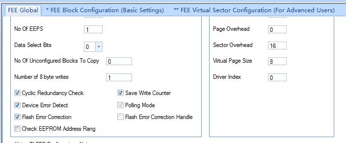

Hi all:
I'm using TMS570 0714 CPU for my project and I'm having a problem reading & writing large amounts of data to the EEPROM using the TI FEE Driver.
I'm trying to wirte the date as long as 8400 byte to FEE blocks,but I don't know how to configure the virtual secto. My configuration done in Halcogen as follows, I don't know if this configuration is appropriate, can
you guys help me ?  too thanks for you.
