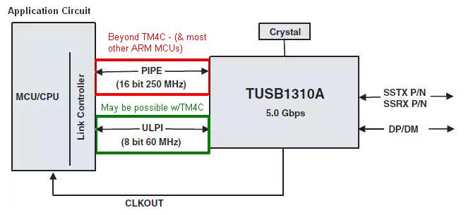

Hello.
We have developed a few USB connected applications using the TM4C1290. Our first tests have used the built-in USB 2.0, Full Speed and CDC. We are transferring an 8KByte block and toggling a GPIO pin at start and finish of the transfer to time how long the transfer took.
Full Speed Configuration: Built-in USB Phy; Full Speed (12Mbit/Second) connection; TM4C1290 running at 120MHz; CDC Communication Device Class
We are able to achieve 8KBytes transfer in 8.18mS. 1/(8.18mS/8000) = 978KBytes per second or 7.82Mbits per second.  Pretty pleased with this result in that maximum would be 12Mbits and there is a lot of USB overhead.
When we add an external USB Phy connected to the ULPI interface.  We are using a Microchip USB ULPI Phy (USB3300).  Using an oscilloscope we can see bit rates of 480Mbits, however, our 8KByte transfer rate stays almost identical.
3 Questions:
(1) Curious if anyone else can confirm these findings?
(2) Is it possible that the CDC class Windows driver has a speed limitation?
(3) I suppose that we might need to figure out how to use the Bulk Transfer mode?
Dan
  • May I note two 'borderline comments' - intended to 'support' your, 'Need for Speed!'    (Perhaps even beyond your (wildest) 'NEED/SPEED' DREAMS!)
    • To my group - 'Transfer implies (both) a transmission AND a successful reception.'      Thus - if  'hand-shaking' and/or other (communication impacting) methods are 'in play' - such 'transfers' may be impacted by the receiving side!     (and the receiving side may 'vary' in its response - depending upon its usage & load demand.)     Has this factor been considered?
    • Your note of another's 'USB ULPI Phy' brought to mind a recent post by (another) here - who sought (both) 'Speed & Robustness INCREASE' - via the technique known as, '8b/10b.'
    This vendor had produced an IC 'TUSB1310A' - which (appears) to enable the use of  'USB3.0!'      As you have 'proved open' to the use of an 'added IC' (surely in the quest for speed)  I believed my arrival  (reasonable) - to insure that you have this (hopefully) new - powerful 'Competitive Awareness!'      As 'Daenerys'  (surely) would advise  'COMMAND'  - (prior to 'Down Boy!')  ...  HAVE NO  SMALL DREAMS!'

  • Thank you for the information.  It would be interesting to look at possibility of using USB 3.0 attached to the ULPI.  FYI, the TI Website states the TUSB1310A as NRND.  I am really interested in speed/throughput experience of other users of the Tiva microcontroller and combination with CDC Windows connection.  Thanks. Dan
