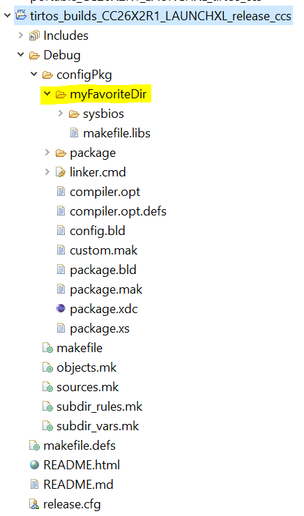

    You can add the following into the .cfg file
    BIOS.libDir = "myFavoriteDir";
    and the kernel objects will be directed to this directory (under the build configuration).
  • Todd, thanks, this does the trick.
    Per this answer, I actually supplied the following configuration script argument (--cfgArgs) to the XDCTools advanced options so that it is not necessary to hard code the folder into  the .cfg script:
    SysbiosOutputDir="${BuildDirectory}"
    In the .cfg  script, I set BIOS.libDir as follows:
    BIOS.libDir = SysbiosOutputDir;
