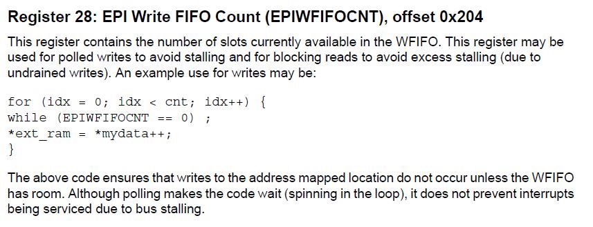

    I think one way to find out if the WFIFO is used implicitly is to first set a GPIO pin before making 4 writes to the EPI interface and then clear the pin. If the WFIFO is used, then you should see the pin clear before the 4 writes are complete. If not, the pin will be clear after the 4 writes are complete. Note that there is still write buffer inside the Cortex-M4 CPU so you may still see the pin clear slightly before the 4 EPI writes are complete.

    Register 27: EPI FIFO Level Selects (EPIFIFOLVL), offset 0x200
    This register allows selection of the FIFO levels which trigger an interrupt to the interrupt controller
    or, more efficiently, a DMA request to the μDMA. The NBRFIFO select triggers on fullness such
    that it triggers on match or above (more full) in order for the processor or the μDMA to extract the
    read data. The WFIFO triggers on emptiness such that it triggers on match or below (less entries)
    in order for the processor or the μDMA to insert more write data.
    It should be noted that the FIFO triggers are not identical to other such FIFOs in TM4C1294NCPDT
    peripherals. In particular, empty and full triggers are provided to avoid wait states when using blocking
    operations.
    The settings in this register are only meaningful if the μDMA is active or the interrupt is enabled.
    Additionally, this register allows protection against writes stalling and notification of performing
    blocking reads which stall for extra time due to preceding writes. The two functions behave in a
    non-orthogonal way because read and write are not orthogonal.
    The write error bit configures the system such that an attempted write to an already full WFIFO
    abandons the write and signals an error interrupt to prevent accidental latencies due to stalling
    writes.
    The read error bit configures the system such that after a read has been stalled due to any preceding
    writes in the WFIFO, the error interrupt is generated. Note that the excess stall is not prevented,
    but an interrupt is generated after the fact to notify that it has happened.

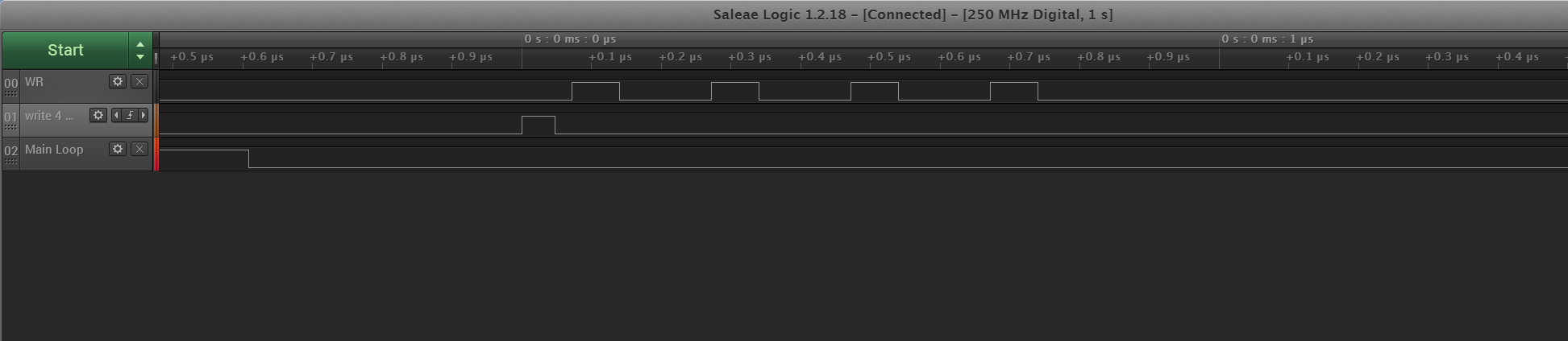

  • OK, I tried the test Charles suggested. Here is the code:
    if ((HWREG(EPI0_BASE + EPI_O_STAT) & EPI_STAT_XFEMPTY) == 0) {  // not empty: there's stuff to read
        in_char = HWREGB(0xA0000000);
        while (EPIWriteFIFOCountGet(EPI0_BASE) < 4);  // wait until there's room to transmit
        set_yellow_led(ON);
        HWREGB(0xA0000000) = in_char;
        set_yellow_led(OFF);
    and this is the result, showing a logic analyzer trace of the WR line (signal 00) along with the I/O toggled during the writes to the mapped RAM (signal 01).
    It can be clearly seen that the 4 writes to the mapped RAM return immediately and the actual EPI bus transactions happen a bit later. This suggests that the XFIFO mode does use the Write-FIFO of the EPI.
  • Hi Guy,
      Thanks for sharing the results. The WIFO is implicitly used and hence disprove my earlier interpretation.
