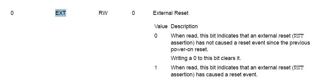

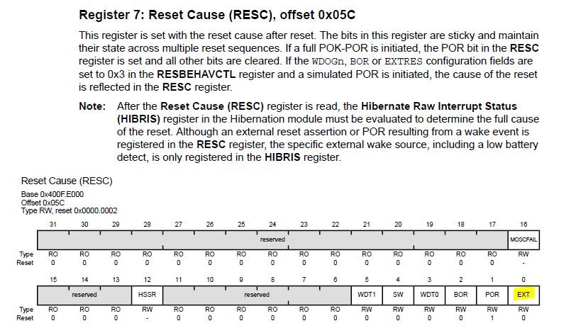

     You can monitor the EXT bit in the Reset Cause register.
  • Thanks, Charles for your Quick reply.
    The EXT bit in reset cause register gives me info regarding whether an external reset has occurred or not since the previous POR? Can I monitor the time between the press and release of EXT reset button like a normal tactile switch connected to a  GPIO input pin?
    Thank you for your time.
  • That is not possible. While the reset button is pressed the entire device is in reset. There is no circuit in the device that can measure the elapse time while the device is in reset. Why do you need to know the elapsed time? Do you have external circuit that can measure reset pulse?
