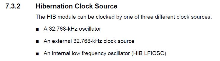

     The RTC can be clocked by three different clock sources? Please see below. The first two are either an external 32.768kHz oscillator or an external 32.768kHz clock source. You were asking how the temperature can affect the oscillator. Since these are external components you will need to refer to the datasheet of the external oscillator of your choice. The vendor of the your external oscillator should have information in the datasheet about the temperature effect on the oscillator stability and tolerance.

  • Hi Nadav,
    Yes, this line specifies an external 32.768kHz crystal to be used.
  • Okay, now I get it thanks.
    I wasn't aware that there is an external oscillator on the board.
    I see an that the RTC is off by about half an hour after 24 hours.
    Will I get better results by using the internal low frequency oscillator?
