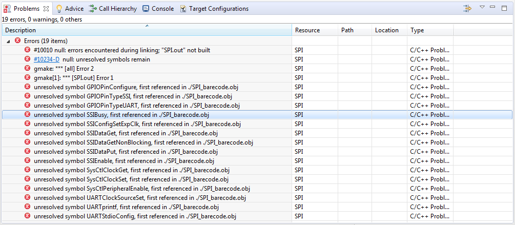

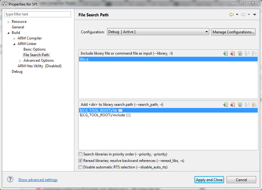

I am working with EK-TM4C129EXL Evaluvation kit. I have tried to create a new project and tried to copy the old project files to new project, Unfortunately I had found few errors.
I hereby attach the screenshots of those  errors.
  • As opposed to creating a new project, I find it much easier to import "project0" from the appropriate TivaWare example directory and then rename the project. In your case you would import from "C:\ti\TivaWare_C_Series-2.1.4.178\examples\boards\ek-tm4c129exl\project0". This way you have not only the TivaWare library includes, but also the correct device defined in your project.
