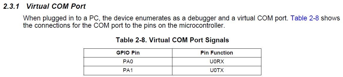

To test my UART setup I wanted to just print to Tera Term, it will work if i use UART0, obviously on Port A, pins 0 and 1, but if i change the code to be UART4 for example, and change the mask values and registers so its Port C, pins 4 and 5, characters wont print to Tera Term. I've included my code, am i missing something?

     On the EK-TM4C123GXL LaunchPad, only the UART0 is connected to the PC for virtual COM port enumeration. See the EK-TM4C123GXL User's guide for detail. Below is the excerpt. If you want to other UARTx for Virtual COM port you will need to have a separate USB-to-Serial adapter.
