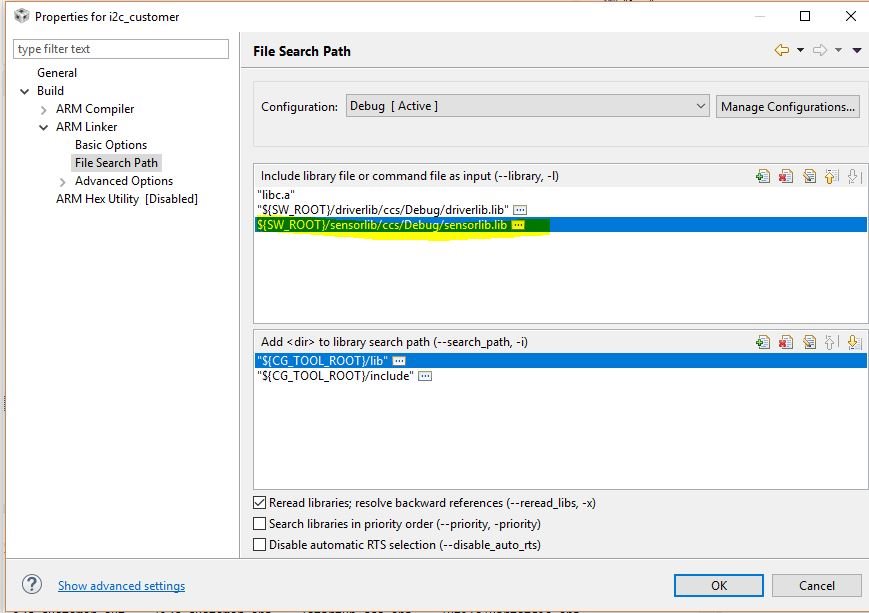

  • If you want to use I2CMInit which is part of the sensorlib you need to link the library. See below.
  • Why wasn't this step necessary for "driverlib.lib" ?
    I use it it too...
  • The driverlib.lib is normally included already in the linker include search path. For sensorlib it is not included in the searchpath by default. You need to include it if you want to use it.
  • Thanks for helping.
    Where can I see what's included and what's not ?
  • If you start off with a simple TivaWare example such as hello or any examples under <TivaWare_Installation>/examples/boards/ek-tm4c123gxl then these projects are built to only include driverlib.lib but not other libraries as there is no need for these examples to reference other libraries but the driverlib.lib. Let's say you are creating a new project that needs to make use of the graphical library, you will need include the <TivaWare_Installation>/grlib/ccs/Debug/grlib.lib in the Linker's search path. If you were to reference the graphic examples projects in <TivaWare_Installation>/examples/boards//ek-tm4c123gxl -boostxl-kentec-s1 then you would have noticed that the grlib.lib is already specified in the search path. Likewise, if you were to try out the examples under <TivaWare_Installation>/examples/ek-tm4c123gxl-boostxl-senshub then you will see that the sensorlib.lib is specified in the Linker search path in the projects as these projects use the sensorlib.lib.

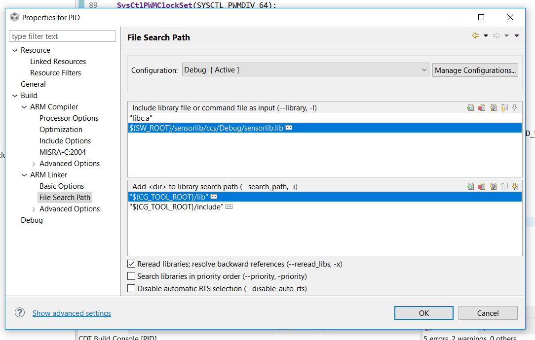

  •  I added the search path and it compiles - but now I get this warning:
    warning #10247-D: creating output section "i.I2CMInit" without a SECTIONS specification""
  • Please refer to the image I attached before. You need both the driverlib.lib and the sensorlib.lib. You are missing the driverlib.lib. Fix this issue first.
