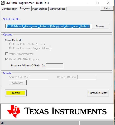

      Did you go to the Program tab as shown below to provide the .bin file and hit Program button? You didn't mention that you went to the Program tab to hit the Program button.

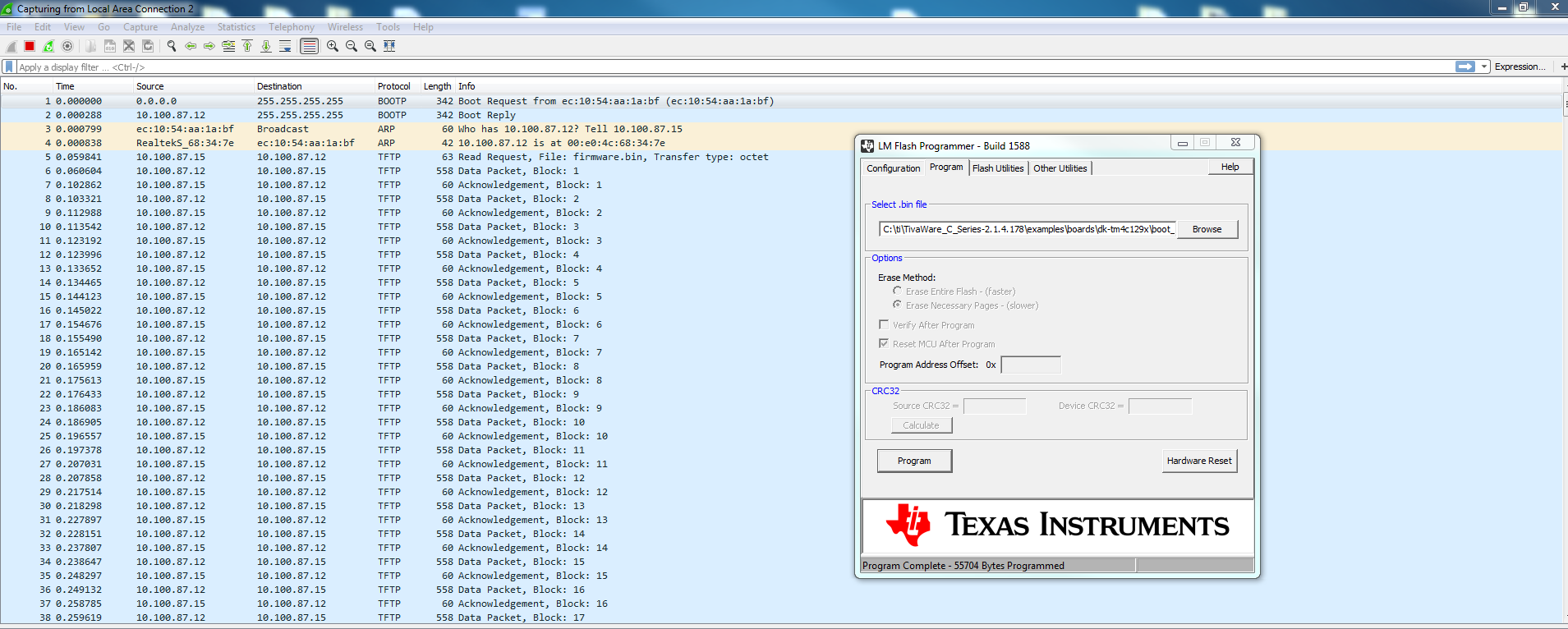

    Once the boot_emac_flash is running it should have sent the BOOTP request to the LM flash programmer. Once the LM flash programmer receives the BOOTP request and after the ARP the .bin will be downloaded to the MCU via the TFTP protocol.

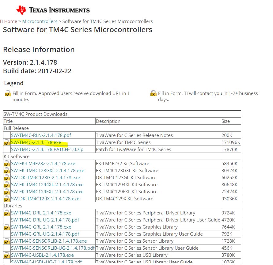

    We use TivaWare C series 2.0.1.11577 and there is no boot_demo_emac_flash example under examples/boards/dk-tm4c129x only boot_demo_uart and boot_demo_usb. Could be related with these ?
      The latest version is 2.1.4.178. Your version is quite old. The latest version can be downloaded from
    You should see the boot_emac_flash and boot_demo_emac_flash in either the dk-tm4c129x or ek-tm4c1294xl folder. I really suggest you to try these examples as is and get a feel for how it works before you attempt to modify per your custom need.

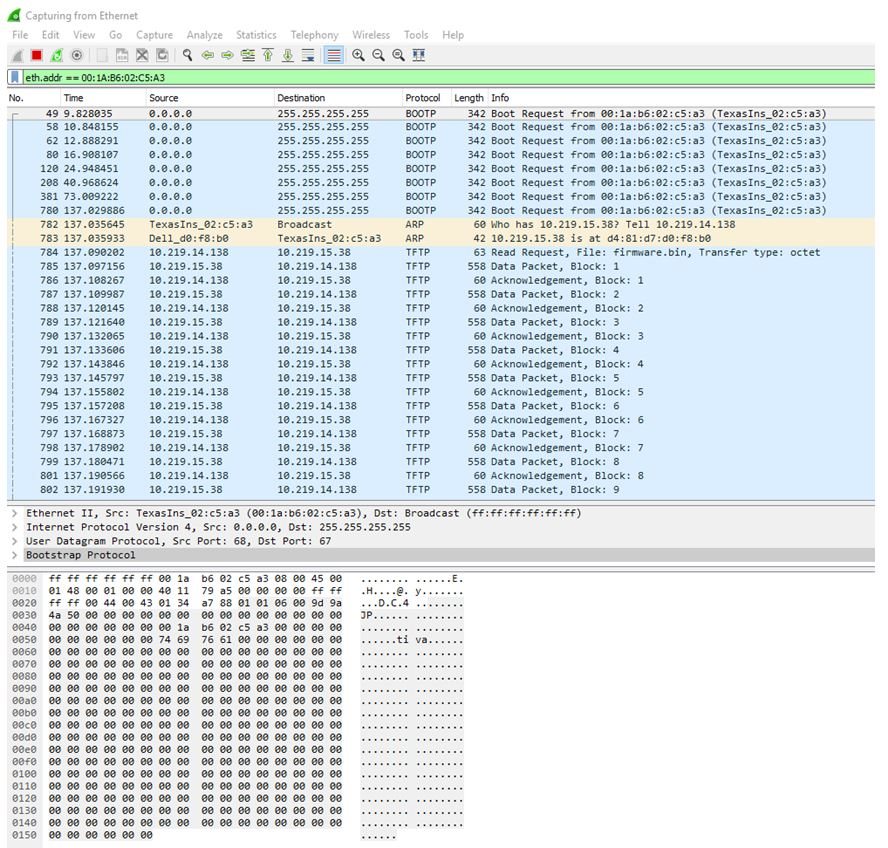

    The problem was about the software version I used.Now, I could start tftp by means of Ethernet. But the board can not open with the sending image that includes udp, uart and i2c communications instead of boot_emac_demo_flash.. Is there any settings for BOOTLOADER start address and FIRMWARE program start address ? I see the tftp packets with WireShark.

    Sorry I cannot understand what you are trying to say here. What do you mean by sending image that include udp, uart and i2c? I'm lost here. In your screen capture you are showing the board is generating the BOOTP request and subsequently the TFTP started to download your firmware to the flash. As far as bootloader is concerned I think this is working.
    Please refer to the bl_config.h file. There is define for APP_START_ADDRESS. See below example. The APP_START_ADDRESS is the address at which your application firmware will be programmed to. 0x4000 is address the example chooses to use. You can use different address if you want.
