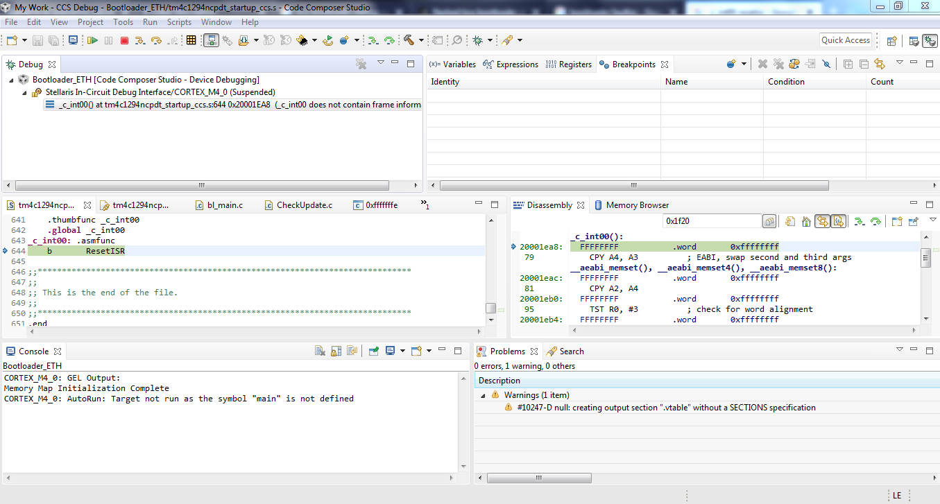

CCS/TM4C1294NCPDT: Ethernet boot loader startup issue when running from RAM. ResetISR not getting called.
Part Number: TM4C1294NCPDT
Other Parts Discussed in Thread: EK-TM4C1294XL,
I'm using Tiva ware board EK-TM4C1294XL with Ethernet boot loader.
The Linker File and the startup code are attached for boot loader.
I'm trying to load the boot loader in Flash and run it from ram.
Initialization model in Run time Environment settings is RAM autoinit
While running the code in debug the entry point is showing start address in RAM but the address of ResetISR in _c_int00 function is showing 0xFFFFFFFF instead of actual address as shown below. The controller goes into faultISR when run.
Can you please tell me what is wrong?tm4c1294ncpdt_startup_ccs.s
