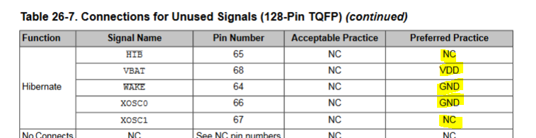

In our project, it is decided not to use the hibernation property of the microcontroller. So, how must we connect the related pins of the microcontroller?
Hibernation module pins might be connected as it is recomended and then not activated with the software, ok,
but for the hardware part, which pin or state (GND or empty) can we connect them safely as it will not used in any time?
