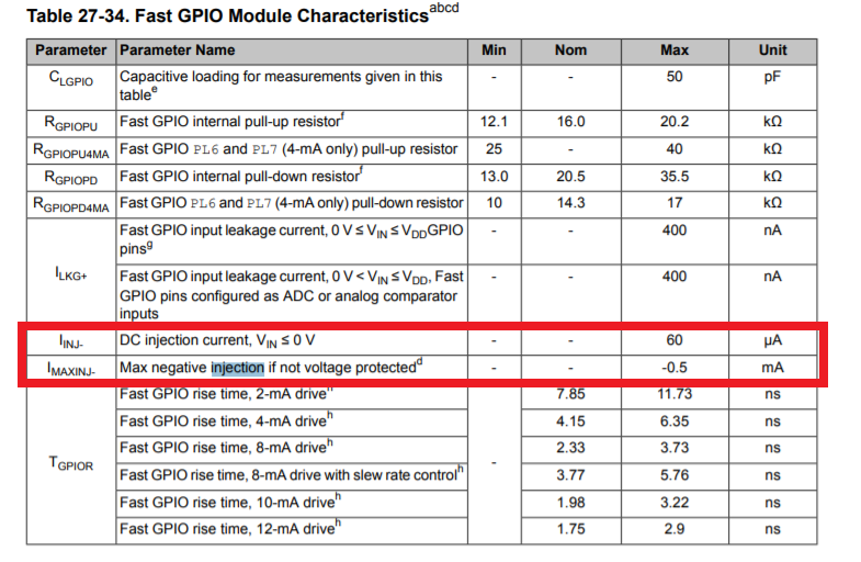

I'm confused as to what the values for "DC injection current, VIN ≤ 0 V" and "Max negative injection if not voltage protected" mean. These values are on table 27-34 of the TM4C1294NCPDT's datasheet, and I'm confused about how would a pin configured as GPIO behave when not voltage protected. I wanted to dimension current limiting resistors in these pins according to table Table 27-37, which contains max positive and negative current injection values. However, since these pins will be configured as GPIOs, now I'm not sure anymore.
