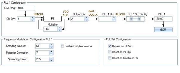

PLL Configuration:

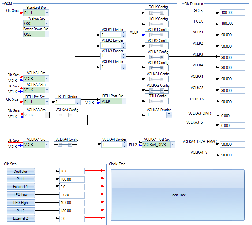

Clock Configuration:

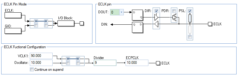

c)         Then, turn off the external watchdog, the MCU's ECLK PIN is configured as a clock output (the normal output value is divided by 9 of VCLK1, which is 10MHz), as shown below. At this time the ECLK output clock is about 0.556MHz, so the VCLK1 clock is approximately 5MHz, so it is inferred that the PLL output is bypassed to 10MHz inside the chip.
d)      Read the GLBSTAT , FBSLIP=1  and RFSLIP=1,
OSCFAIL = 0
the other bits are 0.
e)         Read from fault register, no faults found
The above behavior shows that the MCU fails to detect the PLL, thereby switching the global clock to the chip's internal clock. And the problem time is irregular, sometimes a few minutes, sometimes a few hours.
