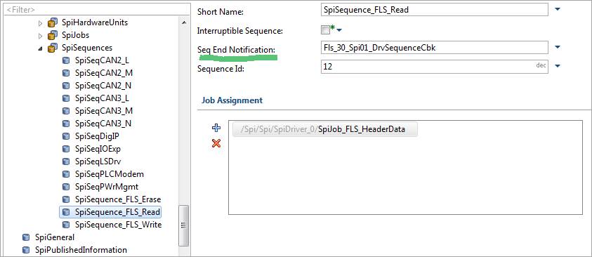

First, the Notification is configured:
Then, the header file containing the correpsonding declaration is configured:
A) The content of the generated files Spi_PBcfg.c and Fls_30_Spi01_Cbk.h do not fit together which leads to the compiler error:
 Compiling file: GenData/src/Spi_PBCfg.c
"GenData/src/Spi_PBcfg.c", line 118: error: declaration is incompatible with "void Fls_30_Spi01_DrvSequenceCbk(void)"
(declared at line 37 of "../coremsr/bsw/fls_30_spi01/Fls_30_Spi01_Cbk.h")
B) Not configuring the Notification Header leads to the warning
"GenData/src/Spi_PBcfg.c", line 1234: warning: a value of type "int (*)()" cannot be used to initialize an entity of type "void (*)(void)"
 Two possible solutions for this issue:
1. Optionally configuring the notifications header Fls_30_Spi01_Cbk.h and manually adapting the generated declaration. This is not a good solution because, after regenerating the file, the adaption must be done again.
2. Configuring the header and deleting the unnecessary declaration from Spi_PBcfg.c
Would you please comment on that?
