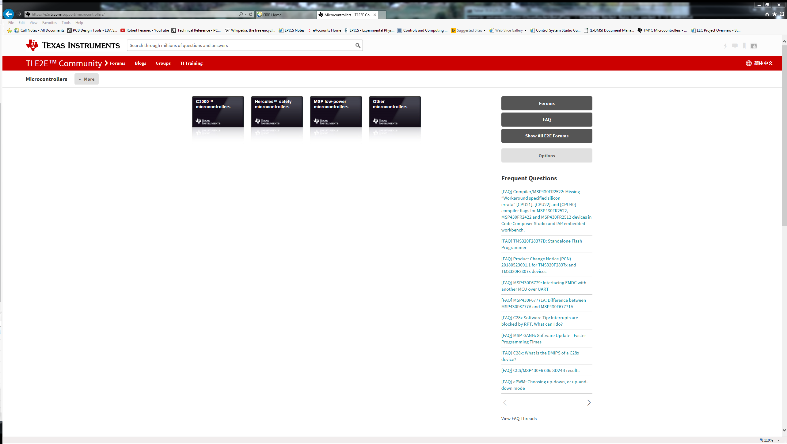

PS: Somehow, the headings on this page got set to only show Chinese.  How do I change them back, or can I?
  • Hi David,
    An engineer has been assigned to answer the SNTP question. Regarding the Chinese characters...can you attach a snapshot of this.
    Todd
  • David,
    Sorry for the delay. I have been working up a test bench to investigate the issue. I will keep you posted.
    ~Ramsey
  •  At least some of the labels have corrected themselves.  When I wrote the question, the "+ Ask a related question" and "+Ask a new question" were Chinese characters.  Also, when I brought up a page to edit, all the text was Chinese.  If I hadn't known what the buttons meant, I'd have been lost.
    Now, I just have Chinese characters over in the upper right corner.

    PS. Regarding the Chinese font on the forums. The button in the upper right hand corner takes you to the China web site. If you go there by mistake, the same button returns you to the US web site. Maybe you went the by accident.
