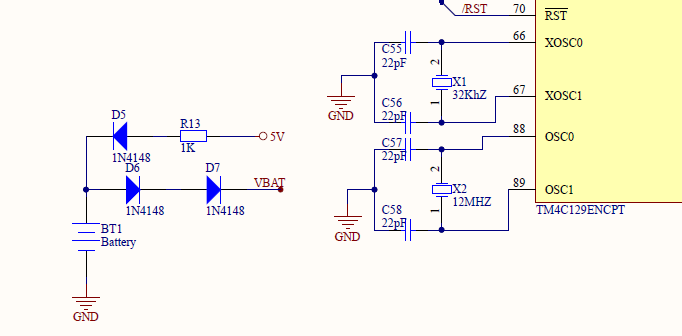

In our product, we are using the in-built RTC (Real Time Clock) feature of the microcontroller. We found that the RTC value is corrupt in the Field (where our system is installed in textile Machineries) once in a while.
Please find the Circuit and Software details below.
We have used TI library in our implementation.
Kindly review and support us to solve the issue at the earliest as we have started our production and this issue would stop our production and reputation with our customer.
Circuit details :

    1, What do you mean by the RTC value is corrupt? Is the value totally wrong or is it off by a little?
    The value is totally wrong. Day, Month & Year values are completely erased. Please find below the picture where the Day is changed to 7, month is changed to 0 and Year is changed to 2000.
    After the above corruption, On 12th Oct 2018, we had reset the RTC value to 12-10-2018. After few days of operation, the RTC value is reset (Day value to 0, Month Value to 0 and Year to 2000).

     I don't know what exactly is the problem. Th DateTimeGet() calls HibernateCalendarGet(). You should check the return value of HibernateCalendarGet() and handle the situation as described in red.  Please see below API description.
    15.2.2.3 HibernateCalendarGet
    Returns the Hibernation module’s date and time in calendar mode.
    Prototype:
    int
    HibernateCalendarGet(struct tm *psTime)
    Parameters:
    psTime is the structure that is filled with the current date and time.
    Description:
    This function returns the current date and time in the structure provided by the psTime parameter.
    Regardless of the calendar mode, the psTime parameter uses a 24-hour representation
    of the time. This function can only be called when the Hibernation module is configured in
    calendar mode using the HibernateCounterMode() function with one of the calendar modes.
    The only case where this function fails and returns a non-zero value is when the function
    detects that the counter is passing from the last second of the day to the first second of the
    next day. This exception must be handled in the application by waiting at least one second
    before calling again to get the updated calendar information.
    Note:
    The hibernate calendar mode is not available on all Tiva devices. Please consult the data sheet
    to determine if the device you are using supports this feature in the Hibernation module.
    Returns:
    Returns zero if the time and date were read successfully and returns a non-zero value if the
    psTime structure was not updated.
