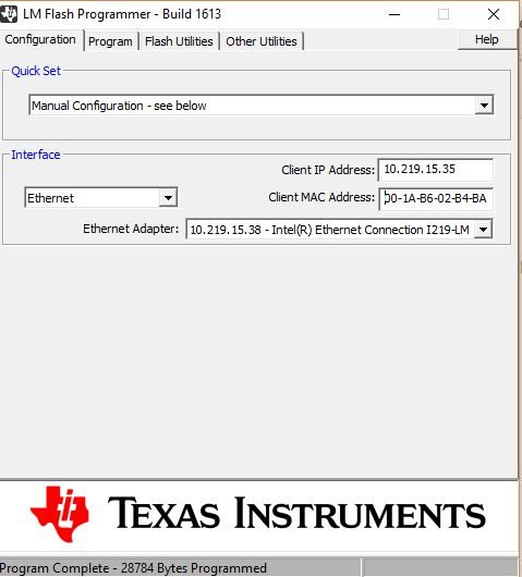

     Ok, my bad. I got things mixed up. I was wrong in my earlier reply. I just tried it and it works. You can try it for yourself just like the UART. See below. You will need to run a TivaWare Ethernet example like enet_lwip first and record the IP address. Afterward, you must erase the flash completely. See below screen to provide the IP address you just recorded from running the enet_lwip example and the MAC address. If you have a LaunchPad the MAC address is displayed in the sticker on the back of the board. You will then go to the Program tab and provide your .bin file. Once you hit the program button the LM flash programmer should receive the BOOTP request from the MCU and start the TFTP download.

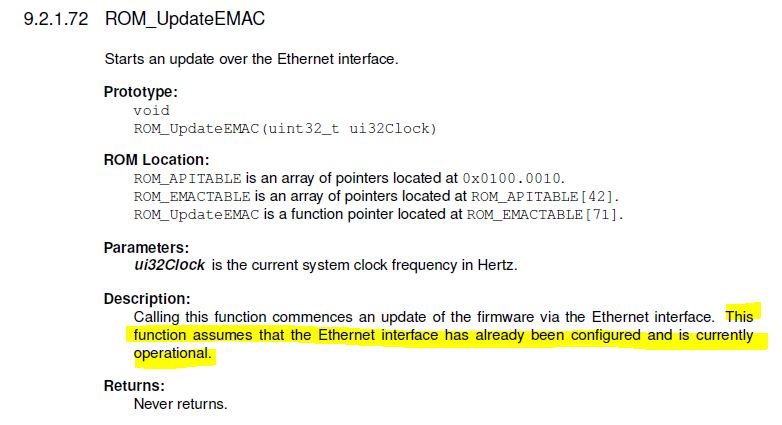

    ROM_UpdateUART();
    AJ
  • Ok, I see what you are trying to do. You want to call ROM_UpdateEMAC from your application code. Yes, do as you what you did for UART to disable all interrupts.

  • I'm not too sure why are you doing the LwIP initiation stuffs? As you pointed out from the other post, you want to exit BIOS and disable all NDK stuffs. You don't want the prior Ethernet settings to stay active when you call ROM_UpdateEMAC. We don't have example to call the ROM Ethernet bootloader when running a TI-RTOS NDK. It will be great if you can get it to work and share with the community.
  • The thing is, once I exit BIOS and disable NDK, how will the LM flash communicate with the device if there is no enabled network stack? By your previous message, I am assuming that ROM_UpdateEMAC takes care of all the network stuff and is that the case then?
  • After you disable NDK you will want to initialize the EMAC/PHY again. I'm not sure if you can retain the EMAC/PHY configuration what was previously set by the NDK. Maybe it is ok to retain the same setting. Try and see if that works. If not, then reinitialize the EMAC/PHY by referencing the TivaWare ethernet examples.
