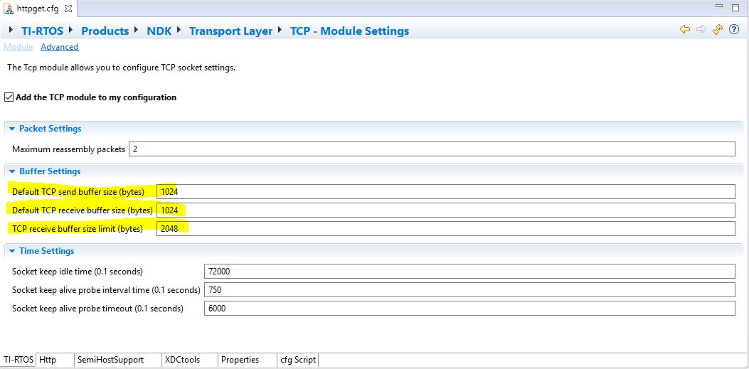

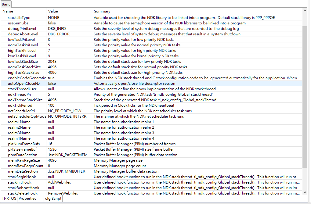

I have problem with http server.
Device:   EK-TM4C1294XL
software/tool: tirtos_tivac_2_16_01_14, ndk_2_25_00_09
I create a web server, which is following "http://processors.wiki.ti.com/index.php/TI-RTOS_HTTP_Example ".

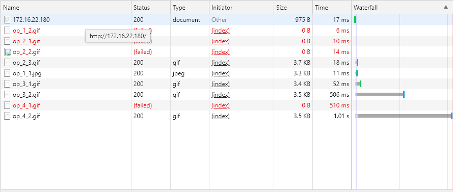

I'm trying to show .gif file on web, but the file always load fail random.

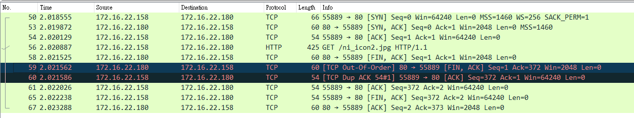

and  the package message in wireshark is below.(zip)
wireshark.zip
I can't solve this. Please help me to solve.
