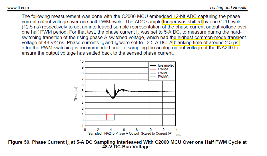

  • Hi Charles,
    My claim is not without merit (below) Piccolo ADC configuration seems to settle near 2.5us after some how shifting ADC trigger 2 SYSCLKS 12.5ns (80mHz).  The problem TM4C1294 60Mhz PWMCLK with 2.5us blanking delay to trigger conversion window seems to miss any and all sample acquisitions. Our original blanking time was 2.5us but discovered ADC was not producing correct measures. The INA240 propagation delay is not 400us so it should not require such huge time delay! This issue occurs even at 24vdc with very small motor current measures, < 1.5 amp.
    Why does it require 400-500us settling time when typical 12 bit SAR requires typically 600ns to (1/2 LSB) resolution with no added C external? Somehow the ADC clock skews far from SYSCLK time domain and (PWM_TR_CNT_LOAD) fails to trigger ADC conversions center of PWM periods. Configuring SYSCLK 60mHz does not correct ADC skew issue that occurs during 40-80us PWM periods. The industry accepted practice does not produce useable nor correct results nor does 2.5us blanking trigger delay after any PWMENABEL register inverter drive event. There has to be an underlying timing issue PLL 480mHz and 30mHz ADCCLK are not synchronous as it relates SYSCLK(120mHz) with PWMCLK/DIV2 (60mHz). The question is how could our clock configuration cause this issue? Missing any clock inputs datasheet block diagrams makes for difficult analysis. How does TI expect anyone on earth to trouble shoot this seemingly bizarre clocking issue from the main clock tree diagram alone?
